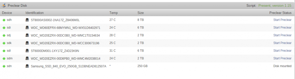

  4. reporting back that 2015.09.28a fixed the issue. No more array members showing as eligible for Preclear.

  7. Yes, 2015.09.28 version
  8. Array is running. I even woke up all disks to see if that had an effect. Its only drives on the motherboard.
  9. PS. Thought maybe it was a Areca issue but in fact these are all the drives connected to my motherboard. See screenie. Shaded serial numbers are on the Areca.
  10. If you're using Joe L. version, you don't. The reason is that the "mail" command used before unRAID 6 could interfere with the built-in Notification system. I've adapted the new system into preclear_disk and submit it here, but there's no response from Joe L. In the mean time, you can use bjp999 version of the script that's stored on my github: I uninstalled Preclear plugin and reinstalled using PLG link from first page, then uploaded the preclear_disk.sh you referenced in quoted text. Now it is offering to Preclear members of my array & cache disk? Something is not right.

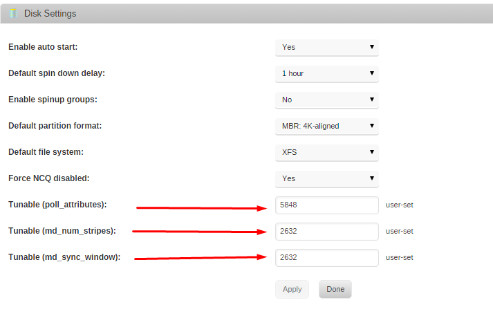

  19. you can restore defaults in the webgui Not all the settings in the disk.cfg are exposed and restorable in the webgui. Including some that are changed with this script, IIRC. script changes 3 settings. All 3 are exposed in webgui if you want to manually restore them.
