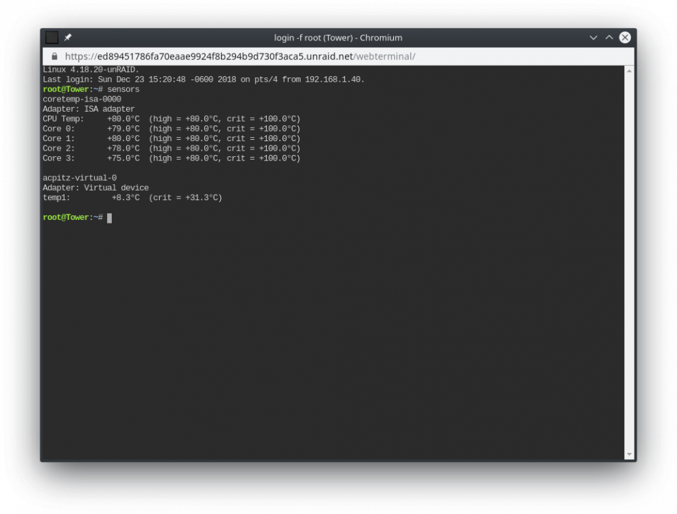

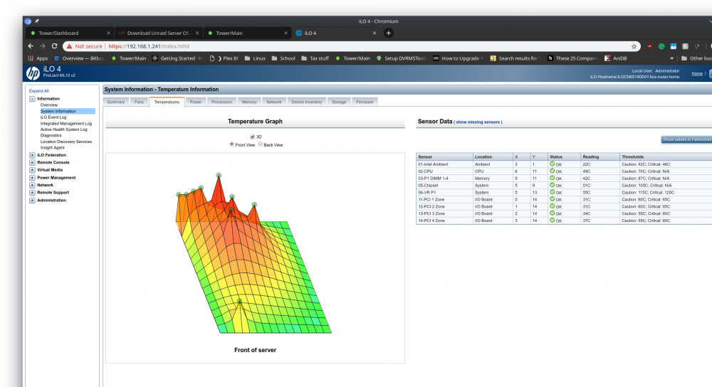

  23. I appreciate your input. The problem I'm having is the fans no longer spin up when the system is under full load. In the past when handbrake was converting movies the fan would spin up but now it doesn't happen. iLO reads 40 degrees and unraid reads 87 degrees which I know that during this use case unraid is correct. It's just strange.
  24. Maybe someone in here can help me with an issue I am having. Ever since upgrading to 6.6.1 my HP ML10 V2 has had a strange issue where the CPU temperature in unRAID reads 80c under full load (this is normal for this machine) but in HP iLO it only reads 50c and thus the fans stay at 20%. I am just trying to figure out what the cause could be and if its something with unRAID or my server itself. I am running the latest bios.
