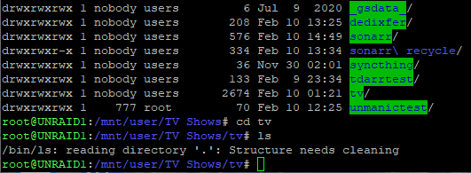

OK, so I carried out a repair and everything is now back looking like it should do but there is no lost+found folder on disk 10 so does that mean I have not lost any files?

Found some problems! Should I do a standard repair? Phase 1 - find and verify superblock... - block cache size set to 1481960 entries Phase 2 - using internal log - zero log... zero_log: head block 443485 tail block 443485 - scan filesystem freespace and inode maps... - found root inode chunk Phase 3 - for each AG... - scan (but don't clear) agi unlinked lists... - process known inodes and perform inode discovery... - agno = 0 - agno = 1 - agno = 2 - agno = 3 - agno = 4 illegal attribute format -36, ino 8589934725 bad attribute fork in inode 8589934725, would clear attr fork would have cleared inode 8589934725 - agno = 5 - process newly discovered inodes... Phase 4 - check for duplicate blocks... - setting up duplicate extent list... - check for inodes claiming duplicate blocks... - agno = 2 - agno = 5 - agno = 1 - agno = 3 - agno = 0 - agno = 4 illegal attribute format -36, ino 8589934725 bad attribute fork in inode 8589934725, would clear attr fork would have cleared inode 8589934725 No modify flag set, skipping phase 5 Phase 6 - check inode connectivity... - traversing filesystem ... - agno = 0 - agno = 1 - agno = 2 - agno = 3 - agno = 4 Metadata corruption detected at 0x46e19c, inode 0x200000085 dinode couldn't map inode 8589934725, err = 117 - agno = 5 - traversal finished ... - moving disconnected inodes to lost+found ... disconnected dir inode 10841621675, would move to lost+found Phase 7 - verify link counts... Metadata corruption detected at 0x46e19c, inode 0x200000085 dinode couldn't map inode 8589934725, err = 117, can't compare link counts No modify flag set, skipping filesystem flush and exiting.

Hi, Just as the title describes I cannot access one of my subfolders in a share but plex and other dockers seem to be able to? I have attached my diags, if someone could take a look I would really appreciate it! The folder in question is /mnt/user/TV Shows/tv This is a new build, upgraded motherboard & cpu about a week or so ago that has been running fine although yesterday I was unable to access any shares, stopped the array and restarted and all seemed fine but I suspect it was the start of this problem. Many thanks,
