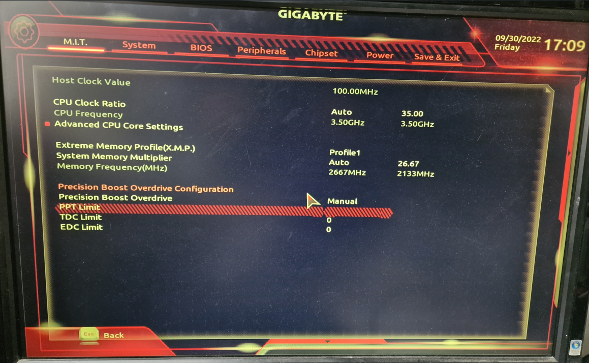

  7. Yes, I understand.... definitely not clear cut but very hard to make any decisions without having another system to compare to. I would imagine that the 12400 in a direct comparison to my 2950X is going to be considerably more ecomical but by how much is (to me) impossible to guage. I have now stopped using tdarr as I encoded everything to HEVC but no more lol! I do have a 3600X server which I decommissioned to save power (it was just a backup server sat there running tdarr encodes) It may make sense to make the 3600X my main and only server as I already have it and will be considerably cheaper to run than the 2950X I did discover the Precision Boost Overdrive setting on my X399 Board but looks like I can only overclock? I need to research this some more as if I can underclock that may be the easiest/most cost effective way to reduce power.

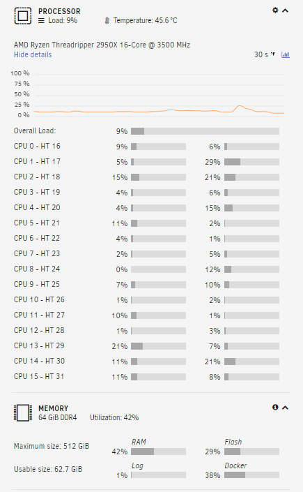

  10. This is what I am getting at the moment on an idle server...
