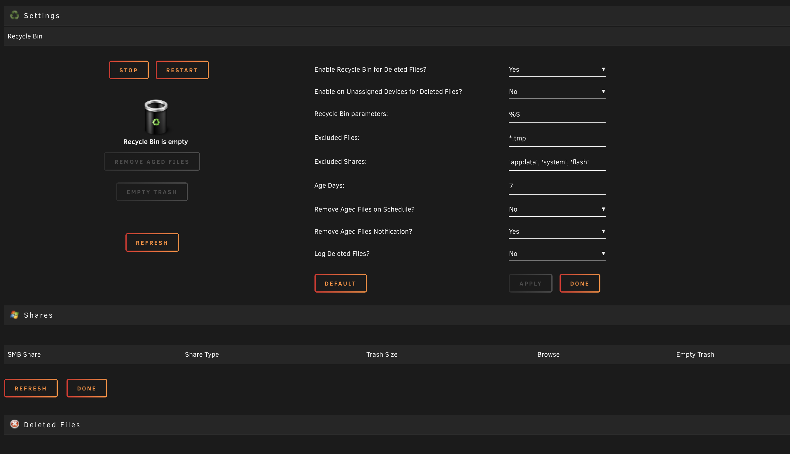

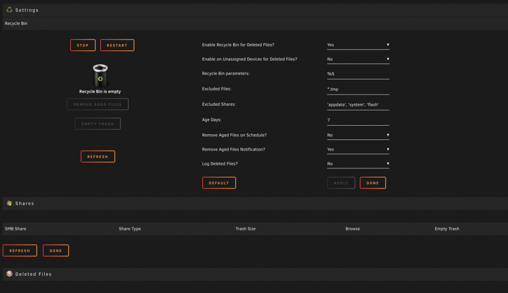

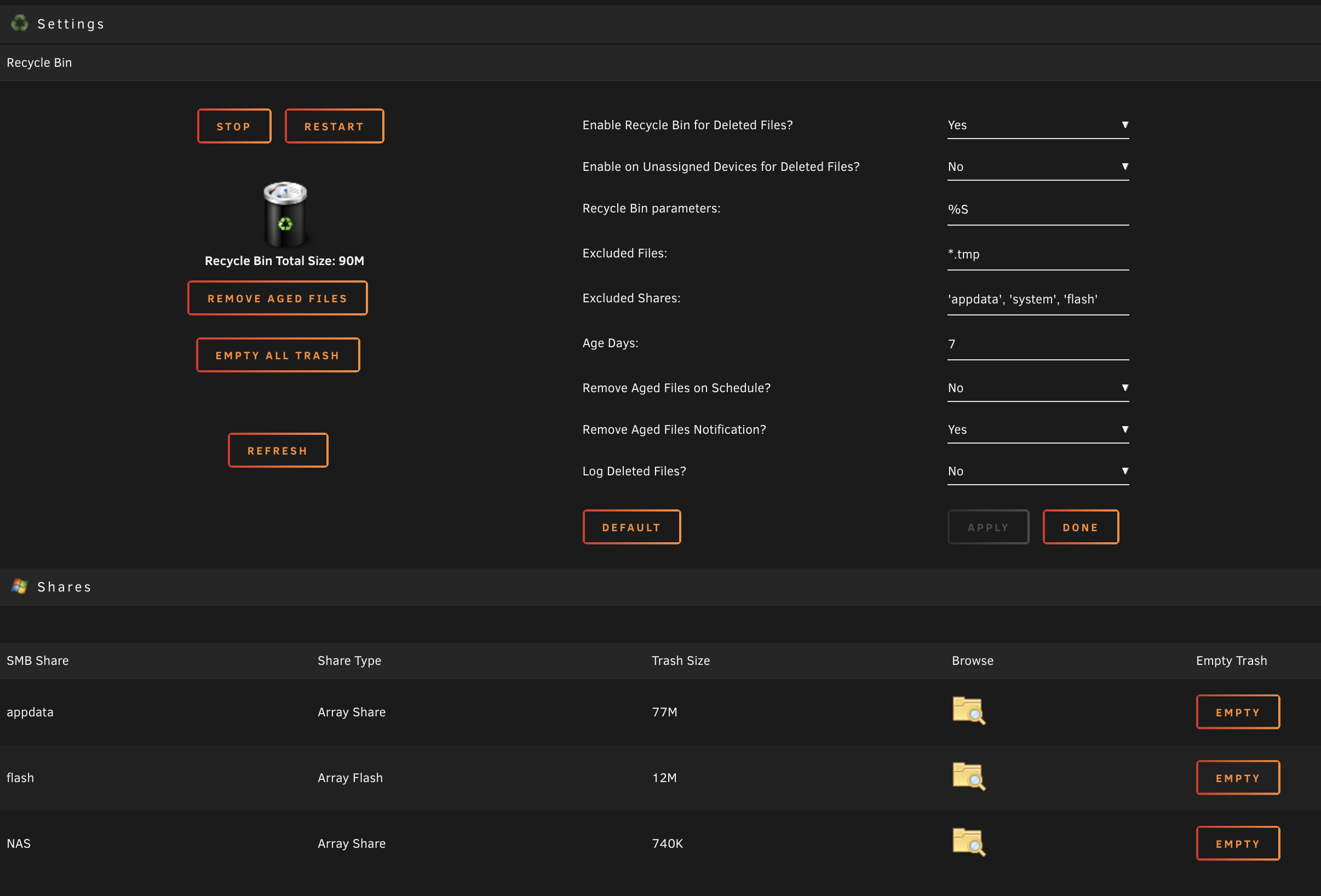

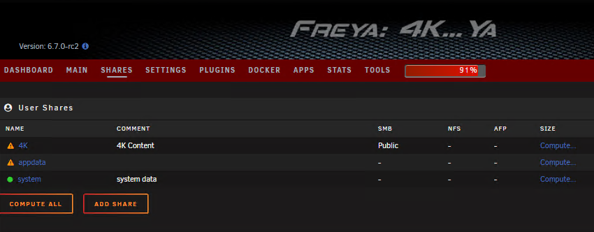

  1. Thanks for the update, works great but might have found a bug... I had appdata, system and flash excluded with the commands 'appdata', 'system', 'flash' the shares tab still shows it all and the main empty all trash button still clears all despite the exclusion

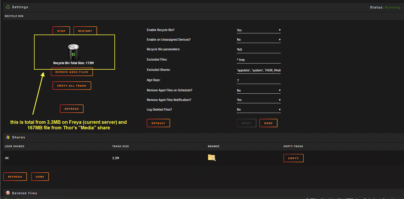

  2. I do have that setting on No on all three servers as you can see in the screenshots (Green is Sif, Red is Freya, Blue is Thor). I do expect that if Enable on UD is set to no that the recycle bin only shows files stored on the server you are actively viewing, I also expect if i exclude a share name mounted by UD that it would also exclude looking at the recycle bin files in that share (mounted locally or remotely) just by its wording.

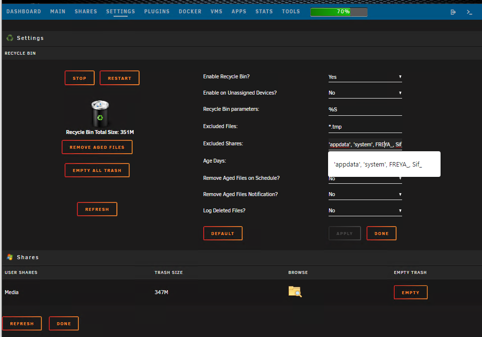

  3. i guess my point is flexibility to exclude remotely mounted disks....UD assigns all mounted volumes to /mnt/disks not /mnt/disk<#> an option to exclude that could simplify the interface and only show what on the the servers local recycle bin i see the main icon at the top one does indeed kind of currently work as a one click solution where all is removed even on remotely mounted servers, where the shares tab below is more finely grained control of only deleting off the current server you are in the interface for. i could adapt but i was initially confused when i deleted a 3MB file on one server and a 168MB on another why the first server is showing 172MB in the recycling bin??...then saw same amount on other server when i emptied on one both servers were cleared. it makes for an easy ooopsie if you mean to check the recycle bin on one server but are ready to empty the other and the main empty button will empty all recycle bins if the remote shares are mounted
  4. maybe the recyle bin could have an option to exclude anything mounted to /mnt/disks/ (not to be confused with local array disks being stored on /mnt/disk#

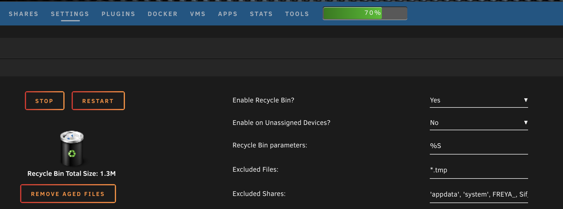

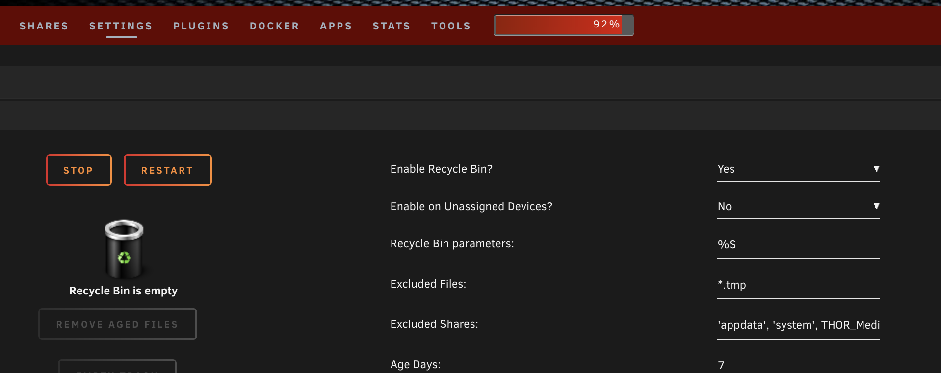

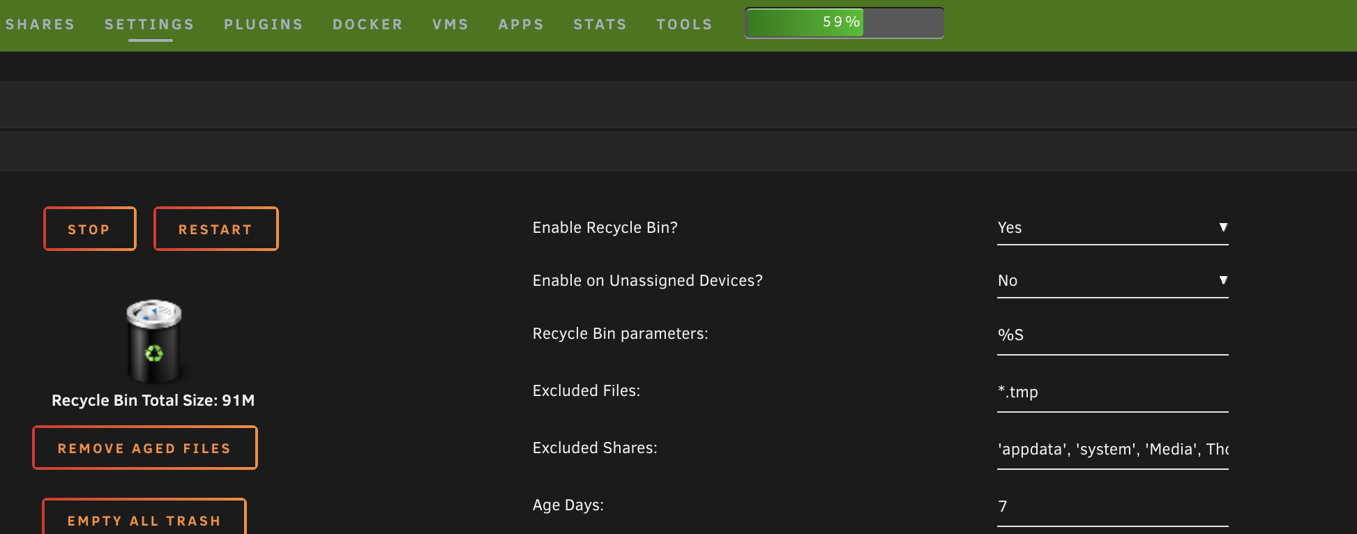

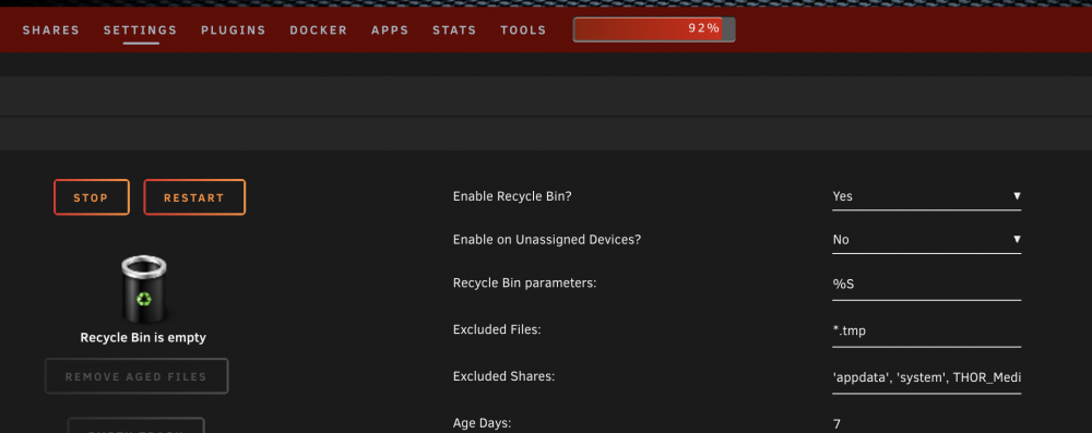

  5. Ok this might make it easier to understand Freya has the red banner and Thor has the Blue one to tell them apart I have the main tab, shares tab and recycle bin settings for the two im mostly concered with (Sif is Green but not listed) I see that the users tab in recycle bin shows only the bin for the server its being viewed on so my question is with the mounts i have on the main page is there a way to exclude Thor on Freya and Sif, Exclude Freya on Thor etc? i have tried with: partial share name 'full sharename' (as Unraid see it where its mounted to /mnt/disks/

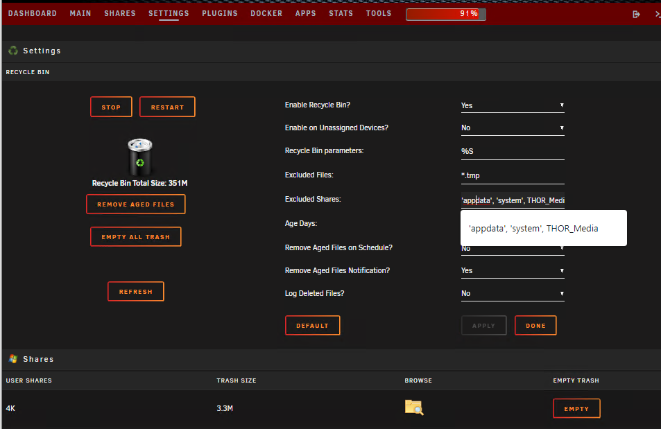

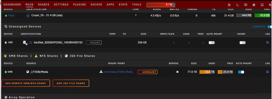

  6. I am little confused. I do want the recycle bin for the 4K share on Freya and the Media share on Thor the main thing im seeing is if i mount a Thor share on Freya i see that the main Recycle bin sees the totals of both recycle bins (the one on Media for Thor and the 4K one on Freya) i found did the upgrade back to Thor for rc2 to be able to mount "remote" SMB shares let me grab some new screenshots and post

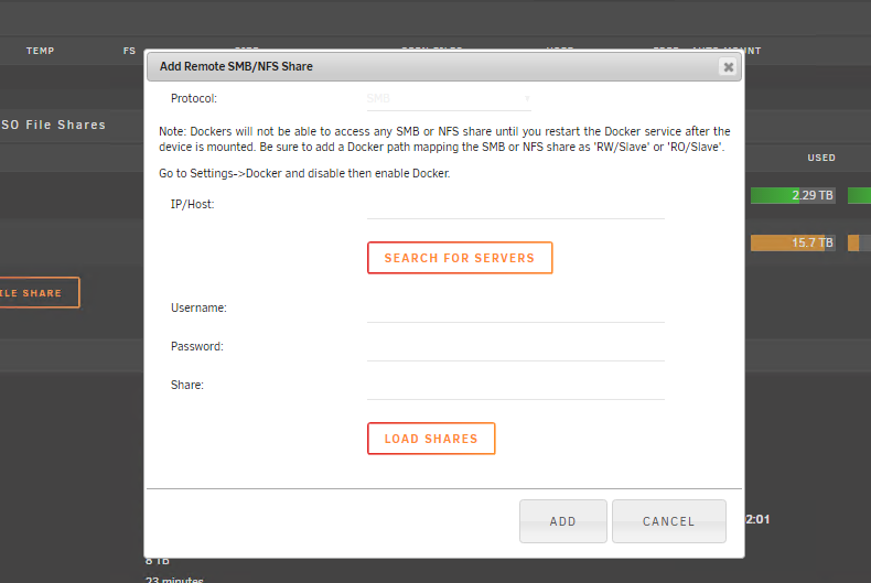

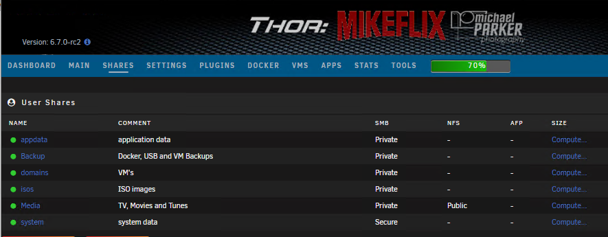

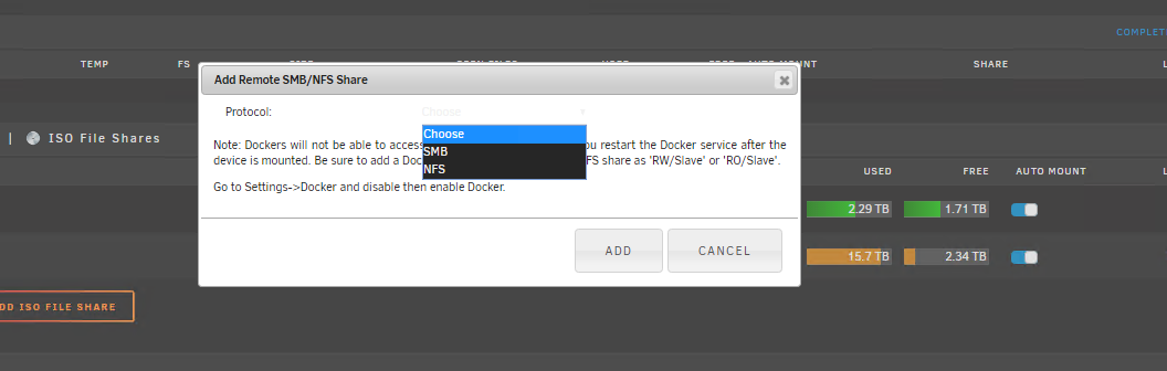

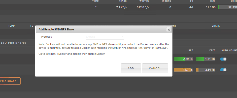

  7. Hello @dlandon me again different issue......Unassigned Devices doesn't play well on 6.7.0 rc2 when using the black theme the pop up when mounting a remote smb/nfs connection it comes up white with white font the other three theme (White, Gray, Azure) are not impacted as they all use a black/gray font, but the black theme uses a white font

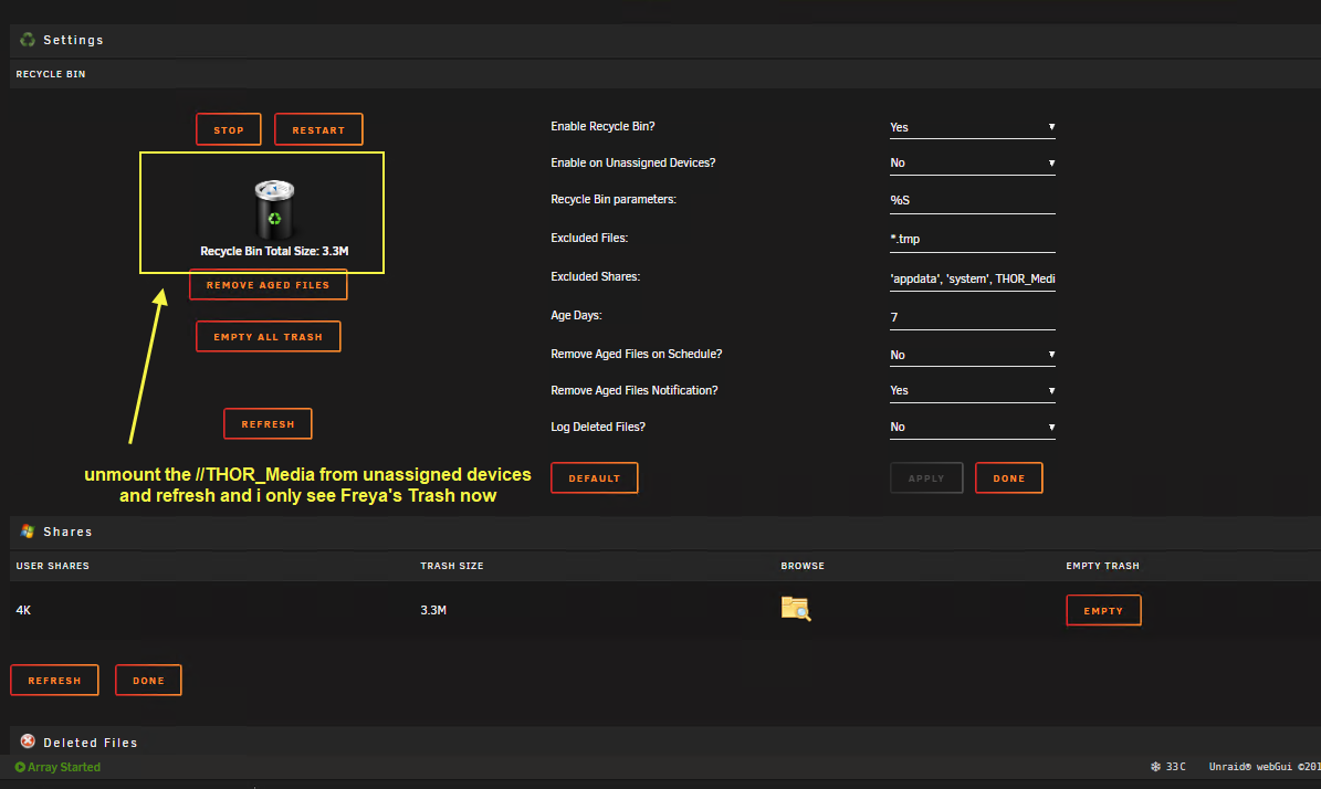

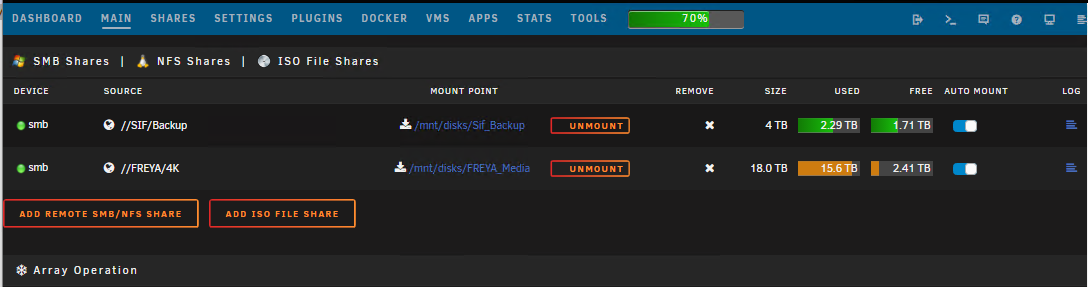

  8. Hello @dlandon here are a couple annotated screenshots...I am troubleshooting thor right now as i cannot mount anything from 6.7.0rc2 onto 6.6.6 Freya has only one share not for system use thats a share named 4K Thor has a few shares but the one i mount on Thor is Freya_Media (maps to /mnt/user/4K on Freya) Freya has a mount of THOR_Media (mapped to /mnt/user/Media on Thor)

  10. Hello @dlandon I am having some issues with this plugin on unRaid 6.7.0 rc2 (wasnt paying attention on rc1 sorry) I run three unraid server all with the recycle bin plugin and a couple shares mapped (using unassigned devices) from and two each ill try and explain the server names are this Thor Sif Freya Thor has two mapped shares /mnt/disks/Sif_Backup and /mnt/disks/Freya_Media Freya has one mapped back to Thor with /mnt/disks/THOR_Media the issue is if i delete files on Freya both Thor and Freya see the same recycle bin size. and vice versa if i delete on thor Freya see the files in its recycle bin, if the files reside on Thor and i empty on Freya both recycle bins empty I have use unassigned devices set to no on all server and even set the shares mounted to be excluded but both still show each others and combined recycle bin can you take a look please and if you need anything else let em know

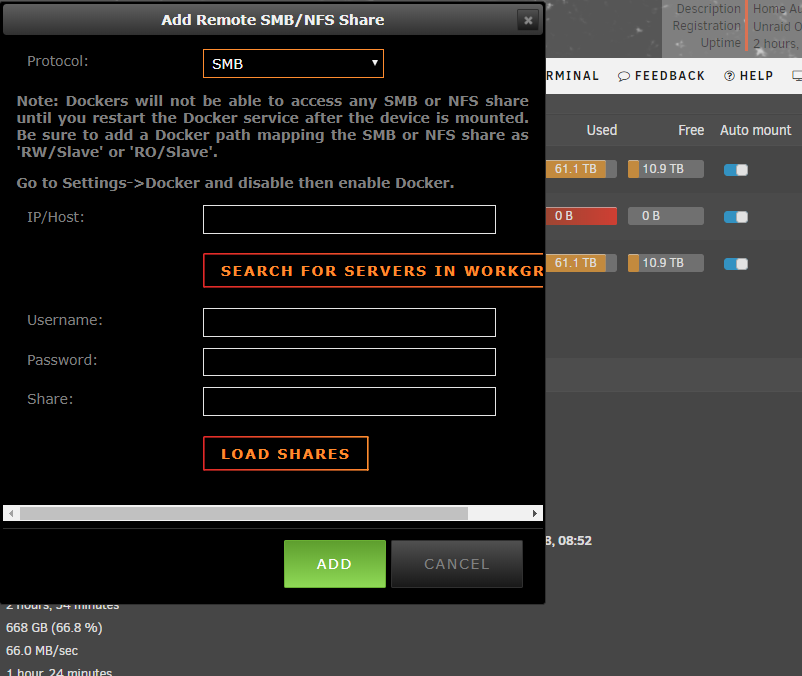

  18. hey guys love the plugin but it needs an update for unRAID 6.6 the buttons for remote smb/nfs connections are HUGE, can you look into this?
  19. just looking at remote SMB/NFS mounting and see the Search for Servers box is so big it does fit on the window
