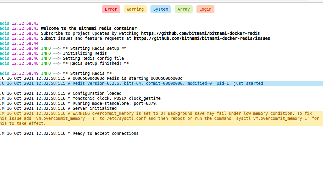

Just setup both redis and paperless-ng. Seems to be working fine except redis shows this error?
Is this normal?
I am having the same issue - the Redis container is being rebooted as part of this.  When I try to follow the directions and run the command 'sysctl vm.overcommit_memory=1' in the container terminal I get the following response 'sysctl: setting key "vm.overcommit_memory": Read-only file system'.
I also can't seem to find the files for Redis within my "AppData" share so I can't modify /etc/sysctl.conf either.
Any suggestions?
Thanks!

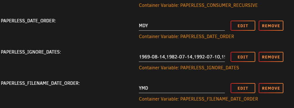

Paperless does not seem to be handling dates in the original file name correctly. It is ignoring the filename date and picking it up from the document instead. The documentation says that filename is used and document is ignored when PAPERLESS_FILENAME_DATE_ORDER is set. However, the consumer is still pulling from the OCR contents. My date format in the file is YYYY-MM-DD. As you can see from my date settings, I have a different date format for filenames for sorting purposes. I should note the the date is usually at the end of the filename too. "<document description> YYYY-MM--DD.pdf". Any thoughts? Thanks.

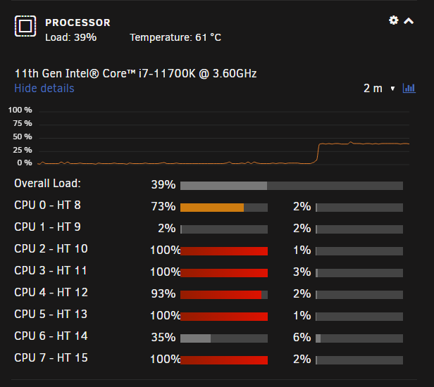

Another question. I have hyperthreading enabled. I have 8 physical cores and 16 logical threads. Regardless of the settings of the workers and threads/worker, the 2nd thread in each core never gets utilized. Right now I have it on 6 workers and 4 threads per worker. I know this is not recommended but I have been trying multiple configurations to get it to work. This is just he latest.

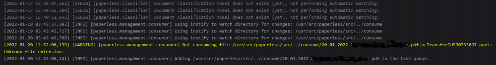

Hey
My Paperless consume does not work and I don't know why
Can somebody help me please?
Not consuming file, Unknown file extension but it is a pdf

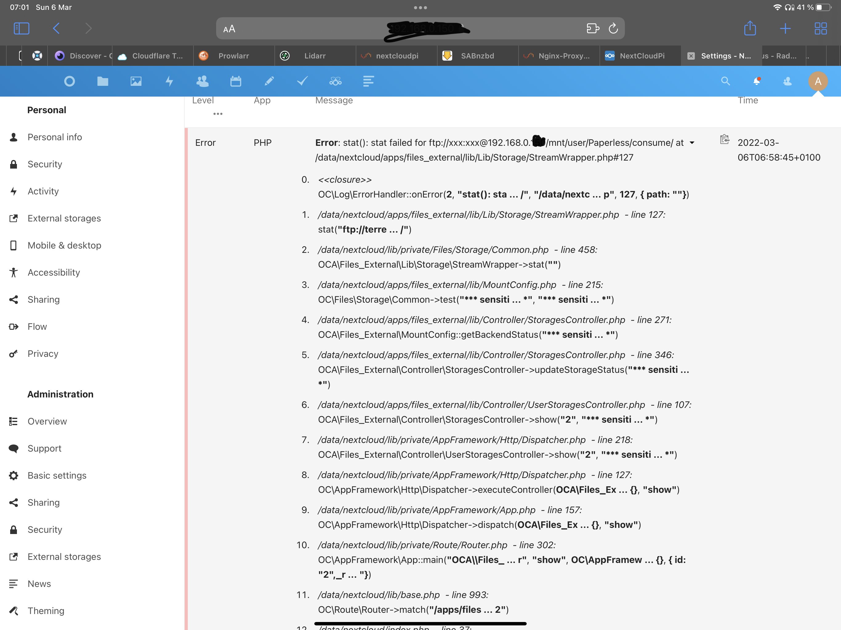

Create external storage using ftp. The consume folder is my Paperless-ng folder. System worked great using Nextcloud. But now switching to Nextcloudpi, it doesn’t. What am I doing wrong? here is the error log. Thanks.
Do I need adjust something in Nextcloudpi?

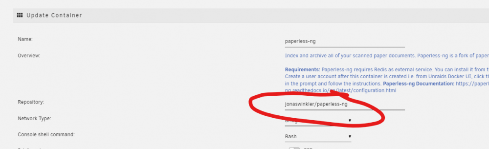

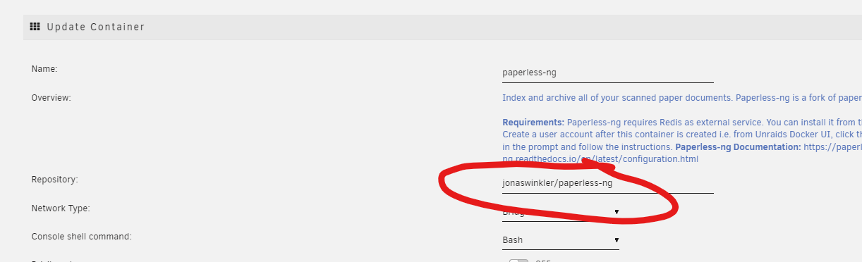

As there first release auf -ngx got publicated is there any plan to migrate the container to -ngx?
You can switch over by changing this:
Let me know how it works :)
