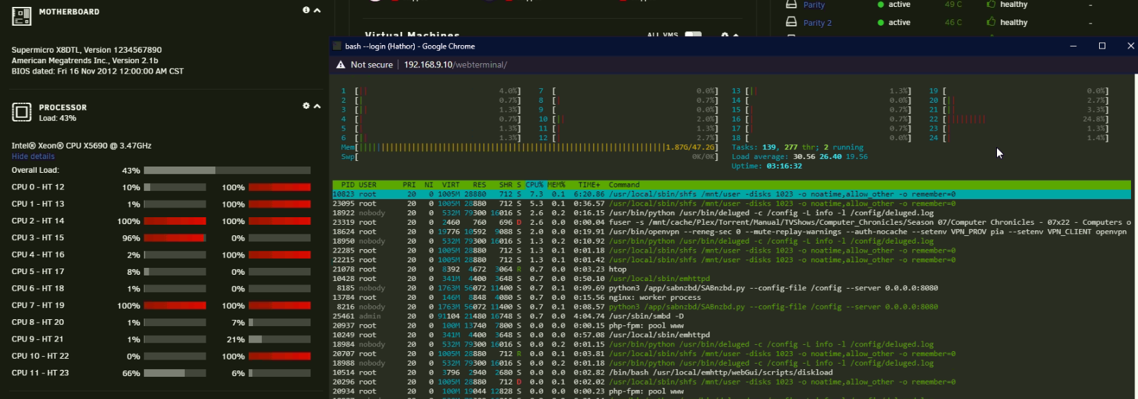

I'll look at the CPU usage and it'll show several of the threads being pegged at 100%. When I look at htop to see what it is, usually it's a VM as the highest process. However, for this test I had all my VMs turned off and only my Binhex-Deluge and NginxProxyManager docker containers running to verify the issue was still occurring with a 'light' workload.

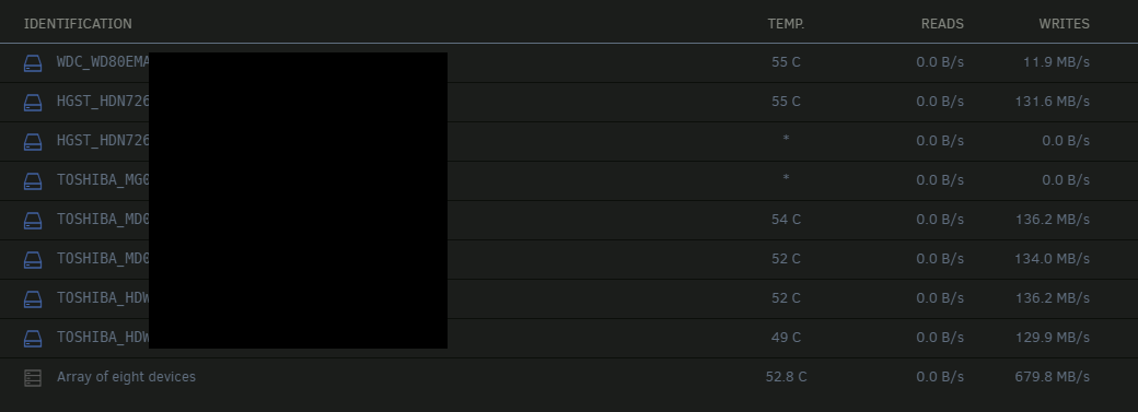

Instead of everything running, I only had Binhex-Deluge and NginxProxyManager docker containers running. And I was copying over some video files to a user share from my other desktop PC: Which was running anywhere between just 5MB/s and 60MB/s, which I feel is crazy slow?  And there happened to be a parity check running (because unRAID keeps crashing, probably unrelated, this was happening prior to the crashing), but that doesn't seem to matter usually.

  1. why doesn't HTOP match the Dashboard? Which one is correct?
  2.  why does everything come to a crawl? The unRAID interface itself seems fine, just the stuff hosted on it.

    2. Is the CPU actually being pegged hard enough to not allow web traffic to the internal services?

Multiple writing in parity array will oveload it, as result core pegged at 100%,  dashboard different with HTOP because dashboard include IOWAIT.

Anyway I can "fix" this? Is it just my processors aren't fast enough? Something else? How can I find out what resource is limiting it? I don't think I see the whole CPUs as pegged, just a number of threads. For example the picture above is only at 47% used. Is that really enough to cause this issue?

Array usually form by mechanical disk, it only suitable for single session I/O per disk, for example, I transfering files ( large file ) to non-parity array, single session per each disk for max transfer efficient.
Edited by Vr2Io
So it's primarily the speed of the mechanical array not being able to keep up with the data requirements and I could help this out by having a large SSD/NVME cache pool and moving my dockers/VMs to a separate SSD/NVME cache pool?
Edited by Majawat
Yes, you need a storage pool suitable for random I/O access.
