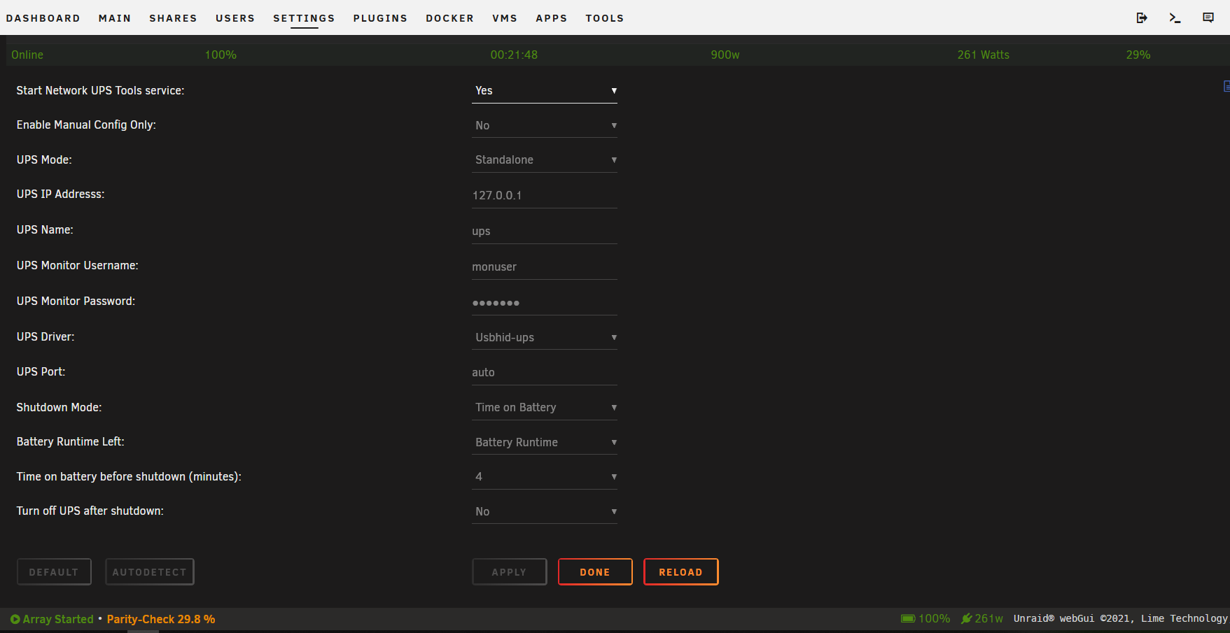

Hey there everyone! I could use some help figuring out why I'm getting unclean shutdowns. I've read multiple posts, checked settings, rechecked settings... Clearly, I'm missing something. Hopefully, it's not too obvious. :)
Using NUT (had the same problem with Unraid's UPS tool, that's currently disabled)
Shutdown Mode: Time on Battery
Time before shutdown: 4
Current shutdown settings:
VM shutdown timeout: 300 (I have 2; 1 Windows, 1 Ubuntu. The Windows box does not get automatic updates.)
Disk timeout: 420
ssh,bash killed by tips and tweaks
The Cyberpower UPS passed it's diag tests (their software, run on my Win10 laptop) and there's plenty of charge left on the battery after the server's off. When I manually shut down the server, it gracefully shuts down in about a minute or so.
Thanks for any and all help!

So any idea as to why it's not getting told to shut down or how I can troubleshoot this further? There's not a lot to configure and it looks like I have it right... Start shutdown after being on the UPS for 4 minutes.
