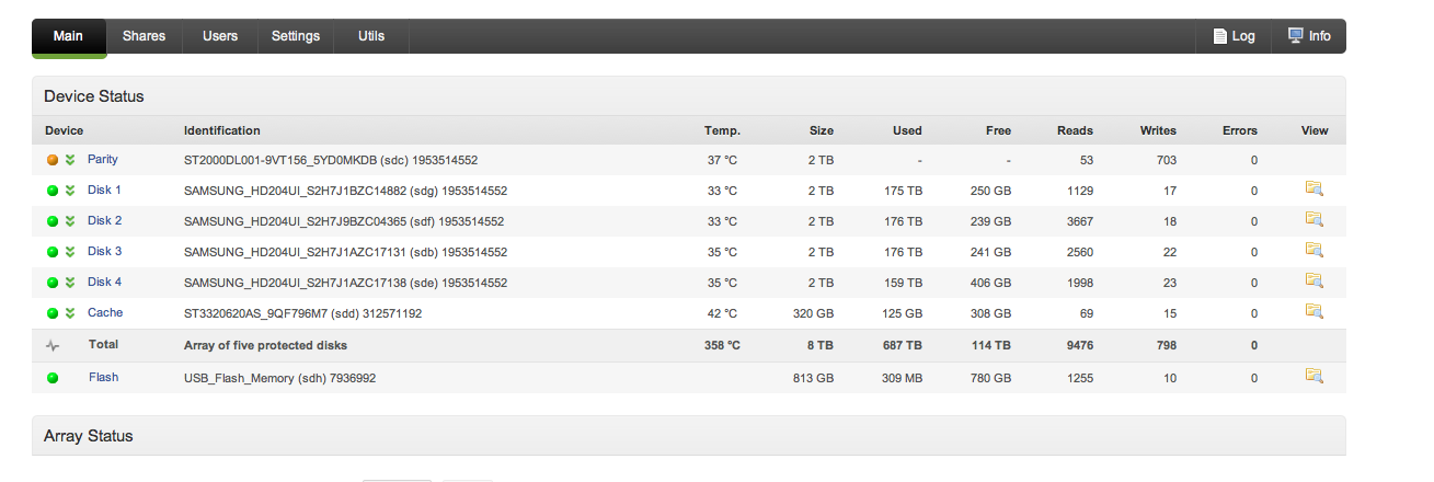

I am using the latest beta7 and I am getting some crazy free space numbers on the home page. Also it seems to be adding the temperatures?? I have attached a screenshot.
You don't find the total temperature to be useful?  ;) ;) 8);D
lol - seeing your array @ 325 degrees might bring on heart palpitations  ;)
Easiest way to fix that is to go to Display Settings and hit apply!
Yeah 325C is just a tad bit high isn't it :)
Thanks a million, going to display settings and hitting apply fixed it.
Brings your "disk consumption" back as well (687 TB is not given to all of us :))
I honestly don't know what I'd do with 687 TB of data...I don't think there are that many movies made that I like, and I like a lot of movies! I'd probably just put anything and everything on it.
