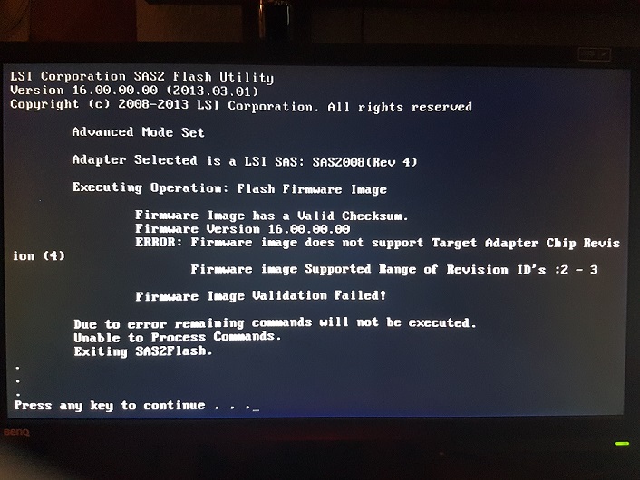

Having an issue two MegaRAID SAS2008's.
On the first card, im Constantly getting "Firmware image not supported" My card seems to be a revision 4, but every firmware i can find only does up to 3. Image attached of error. Is there anyway to bypass this check and just force it to flash?
On another card however, i cant even get that far. Unsure if i have bricked it or if its beyond saving but i ended up making a thread for it here.

Any help would be massively appreciated! Been at this for hours now and have been getting nowhere. Tried virtually every firmware i can find on the first card, second card i kinda gave up hope on.

Took every firmware from this link, every one now comes up with "Error: Firmware image does not have a valid signature"
Went direct to LSI, but the rom file they provide to flash using megacli i cant seem to use because megacli doesnt find my card
The screenshot you posted shows the card being recognized as SAS2008 but your post on the other thread says SAS2108
Which one is your card? You might be trying the wrong firmware
It is a Fujitsu D2616 which according to its documentation is a SAS2108 based card. However, it identifies itself as a SAS2008 card revision 4.
http://sp.ts.fujitsu.com/dmsp/Publications/public/ds-py-raid-56-6G-D2616.pdf
No SAS2008 firmware i can find seems to support revision 4, nor even mentions it and the SAS2108 firmwares i have tried all give that signature error.
Im at a loss at this point

As far as i can see from the links you have, it is always about SAS2008 cards!
The problem is that Fujitsu is not LSI.
Although the card may be "just rebranded", probably there are checks in place to prevent crossflashing with LSI or other firmware.
For example, when talking about SAS2008 cards there is a key firmware (P07) that will allow you to override the "Vendor mismatch".
The newer versions will not offer this opportunity and instead just quit with an error!
Do you have an original Fujitsu Firmware that you can flash?
Is there an HBA firmware from Fujitsu?
And be careful to pick the right one! I used a tool from Fujitsu in a similar situation on a D2607 and successfully bricked the card.

Sorry, wrong link. All the 2108 FW cause the signature error
Still have the original files, hopefully can just flash that back.
Fuji doesnt provide any files or bios's for the card that i can find. They also do not support IT mode or pass trough, only solution is to make every drive a RAID0, but then you cannot add more drives without destroying the entire config. Making it useless for unRAID in my case.
Thanks for all your help so far, i was hoping this would be a quick flash but its turned into a multi day nightmare haha

I'm totally confused about the 2008/2108 issue, but if it is recognized as a 2008 rev 04 by megaraid, you can try the latest firmware found here: http://www.avagotech.com/products/server-storage/host-bus-adapters/tab/tab4#tab-current-drivers4-abc Look for the one listed under 9211-8i_Package_P20_IR_IT_Firmware_BIOS_for_MSDOS_Windows
That one is P20 and was released very recently (03/2016). It might support rev 04 if it truly is an SAS2008

Think tbh im going to give up on both these cards.
All 2008 FW isnt compatible with its revision number even though it identifies itself as a SAS2008
All 2108 FW is compatible but will not install with the signature error though Fuji says its as SAS2108

Howdy all!!!
I stumbled upon this thread because I have a MegaRAID SAS 8708EM2.  While I was doing my research, I determined that in order to use this adapter as an HBA (erroneously) it appeared as though I needed to cross-flash it.
I followed the directions in the first page of this post for what I thought was a compatible card...
After the reboot step none of the command line utilities can read the card, they all say adapter not found (or something similar)...
Did I just brick this card for good, or can I at least bring it back for RAID capabilities??
