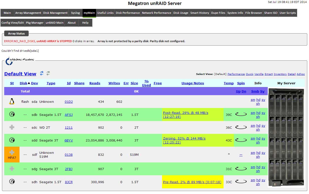

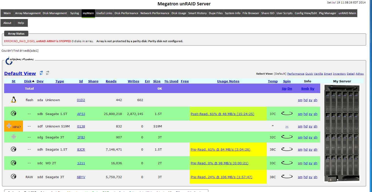

I am currently preclearing 3 drives at once from the console.  I used control-c to get a new prompt each time. Is there anyway to monitor all 3 preclear sessions from the console, webgui or telnet?  The console currently shows me the last session I started.

IF you used a control-c, you killed the process that was running in that shell!  SO you can only run one preclear function per shell.
You can run multiple shells, you use alt-F1, Alt-F2, and alt-F3 to get to the first three shells.  (You can run up to six shells.)  Start a preclear session on each disk in a separate shell.  You then switch between the shells with alt-Fx key sequence.

Oops. That perfect.  Thank you!!

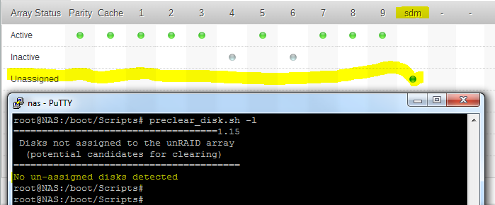

Question.  i have a 4th drive in the machine.  but preclear -l does not list it as eligible.  I previously used it as a snap drive I think.  Anyway I want to clear it.  Is there anything I can do to convince preclear to let me clear it?  format it or soemthing?
It must NOT be assigned to the array, and NOT be mounted, and NOT be currently in use by some other program.
Formatting it will not do anything to help... if the preclear script thinks it is part of your array, or already mounted, or in use in some way, it will not let you shoot yourself in the foot by writing zeros to it.
I got it Joe.  But this machine has no Array.  It's just being setup now and I am using it to preclear all the drives I have lying around the house.  The 2TB in question was taken from my production unraid machine.  I previously used it as a SNAP drive before I had a PRO license.  So maybe it has some data on it that makes Preclear think its in the array.  But there is no array.  So is there anything I can do that will let me preclear this disk?  It's serial 1211 in the attached pics.
Solved.
Strange.  Preclear -l did not show my 2TB WD EARS drive as eligible for preclear.  But I knew it should be and I successfully started the preclear.  I just ignored preclear -l
I wonder why the drive was not in the -l list.
Anyway.. preclearing away!  thanks again Joe.

I am also having an issue where a a drive that was formerly part of the array is not shown by "preclear_disk.sh -l".  When I execute "strings /boot/config/super.dat | grep 2604" (the disk's serial number ends in 2604), I get "A5812604", which is the end of the disk's serial number.  Further commands make the preclear script think the disk is in the array.
The preclear script will clear the drive as other mention above.
I am using preclear v1.15 of and unraid v5.0.5.
I have no way to help you there.  Since unRAID has no definitive list of assigned disks, the -l option of the preclear script looks in super.dat too.  You assigned it, so it is there, and apparently the value has not been overwritten by another disk's serial number.
If you are sure of the disk, it will probably let you pre-clear it.    It is just being VERY cautious.
At least we know why it is happening.  I'm also not sure how to handle this without the possibility of listing a disk that is in the array.
On older arrays, lime-tech used disk.cfg.  It was easy at that point.
Newer versions of unRAID no longer used disk.cfg in the same way.  It could not be relied upon to determine assigned disks.
With the newer cache-pool, etc, I've no idea what is the definitive list of assigned devices.  Best to be overly cautious.
At some point, I expect a native preclear to exist.  At that point, it will be Tom's job to determine which disks are assigned, and which are not.
