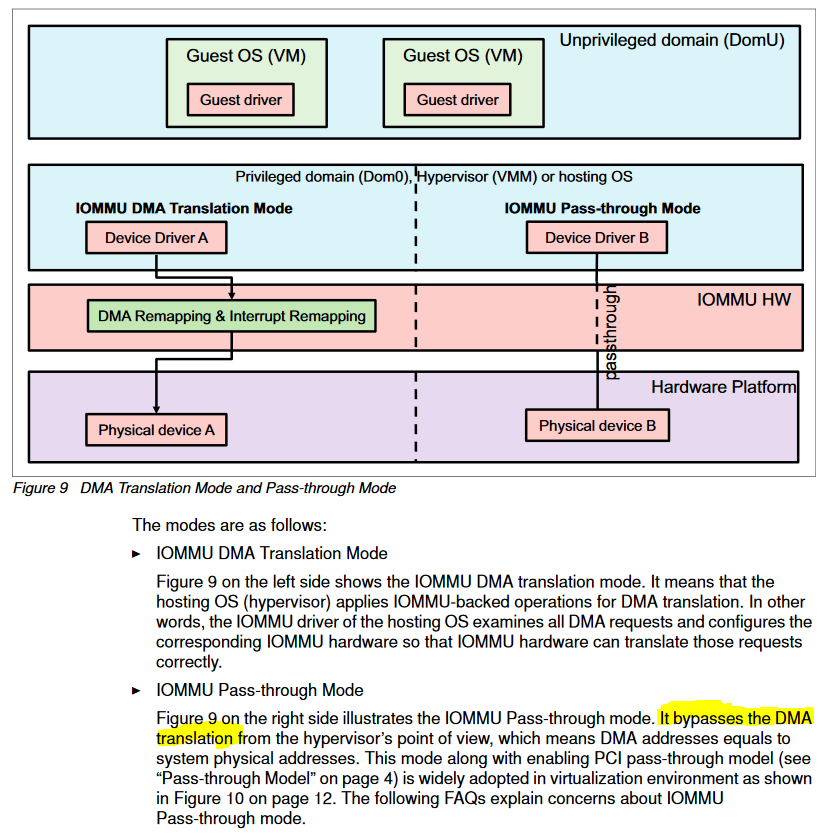

If I understand this correctly, there can't be DMAR errors, since there's no DMA remapping, from the pdf linked above, pass-through mode is the one on the right:
