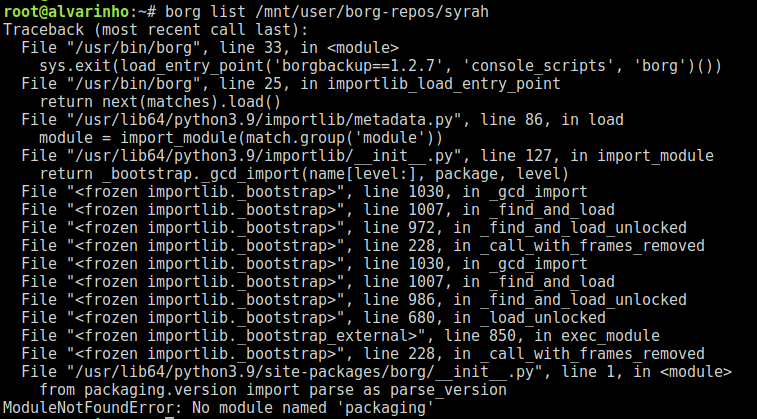

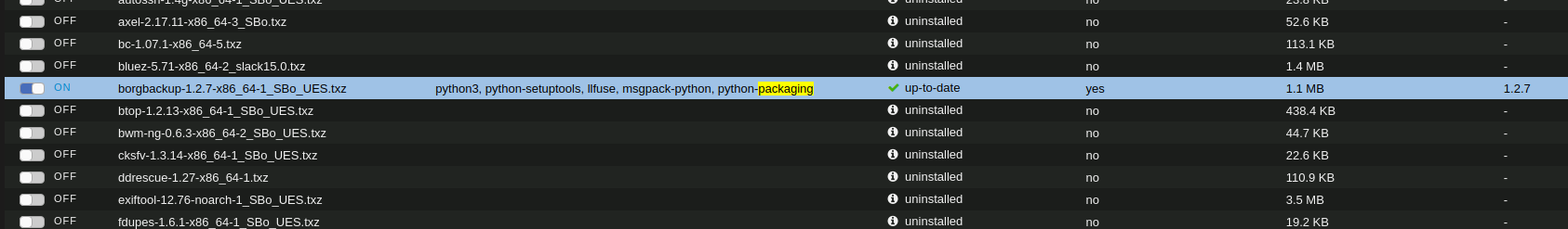

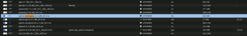

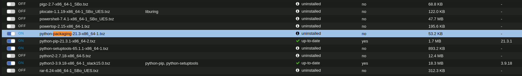

I've installed borgbackup package (borgbackup-1.2.7-x86_64-1_SBo_UES.txz) but after every reboot it stops working because one dependency gets broken (python-packaging).
This is the dependency package state after reboot, the toggle is ON but the state reports uninstalled.
And if I try to run a borg command:
The workaround is to toggle off the dependency package button, press apply and after that it'll be reported as "up-to-date" and starts working again but it's annoying to have to do that every reboot.

I have a build of Python + Pip + Borg and instructions here if nothing else ends up working. I'm using it  successfully on 6.12.8 right now.

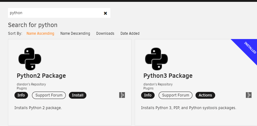

Thanks for the suggestion - any idea how this would work with NerdTools plugins that have dependencies on python? For example if I install these dlandon packages to get python 2/3 and then install a program via NerdTools which, within NerdTools has python listed as a dependency, NerdTools will try and install its version of python right? Do I need to worry about these conflicts?
your mainly wanting to grab the py setup tools pkg.
python3-setuptool
per post with others and links were taken down and other as it causes problems with implementations...
The other issues is that python is version ahead of Slackware and a premade binary for the latest version doesn't exist.
when I last check slackware python 3 stopped around version 10. While python 3 v12 is the latest version...
Hence, a lxc/vm of debian/ubuntu and venv of python is the most optimal.
