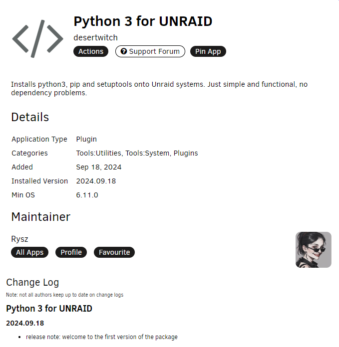

A Big Thanks to Rysz!
For thoses looking for python.
You will need to remove the nerdtools plugin or any and all python application in the extra folder!
Please see new plugin:
root@BMM-Unraid:~# python3
Python 3.11.10 (main, Sep  8 2024, 13:14:52) [GCC 14.2.0] on linux
Type "help", "copyright", "credits" or "license" for more information.
