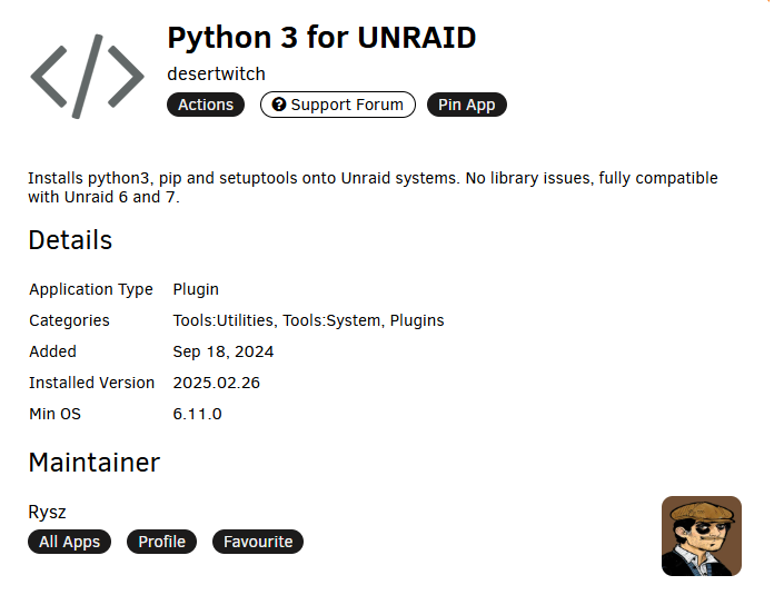

I appreciate Rysz for maintaining a Python 3 virtual environment plugin, which provides some functionality at the host level. However, 90% of the tools Unraid offers are already available in Docker form. In my opinion, much of the desire to run applications at the host level comes from misconceptions about folder passing and usage inside Docker containers, as well as concerns about Docker’s resource overhead.
As long as the "extra" folder for third-party installations remains and the Python 3 plugin continues to be supported, I see no issue with Nerd Tools being deprecated. Most modern applications, such as BorgBackup, are already designed to run within a Python environment.
