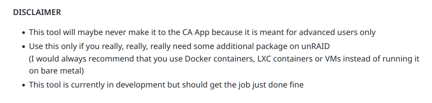

Also please note this paragraph in the repository, that's why I don't advertise it on the forums:

I completely agree on that, un-get is very mature however but I won't create a support thread for that nor will I ever make it available through CA because it is for advanced users only.
