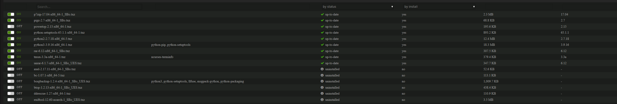

I have not had an update from this app that i know  of in at least a few months. How can i verify that my versions are updating and working as expected:

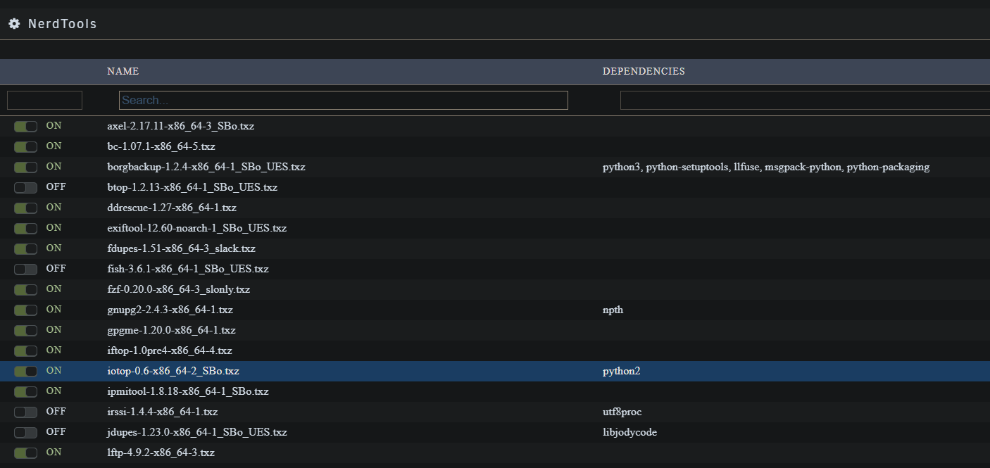

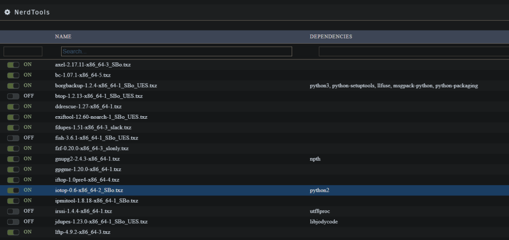

There is something wired with my setup. I am looking for nvme-cli tool and I saw someone already requested it. Then I start looking around but I can not find it in my NerdTools
Then I found it is present in below location
At the same time I can see NerdPack location with some packages in there
What is the problem with my config? Does the NerdPack can somehow interreference with NerdTools? I have NerdPack uninstalled. Shouldn't be these removed as well?
It's not there, not found in packages.json.
Was requested but never added, and the desc file has apparently been taken from the old NerdPack and that entry wasn't cleaned up. Maintenance for this plugin has quickly become almost as spotty as for NerdPack...
Edited by Kilrah
un-get is the solution for this? I was trying to installpkg but the nvme-cli wasn't found after that
