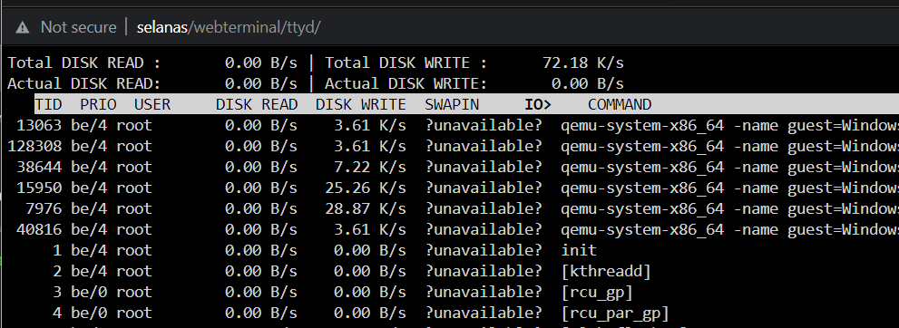

But now I'm getting a warning when iotop runs:
CONFIG_TASK_DELAY_ACCT not enabled in kernel, cannot determine SWAPIN and IO %
Any idea how to fix that?
Thanks

Can you type in the terminal
sysctl kernel.task_delayacct=1
and see if it works ?
When you type that command you have to exit and re-enter the terminal and run iotop again. If it works fine you just have to create a script with the user script plugin and add a new script with the same command you put in the terminal and tell it to run when you start the array.
Best regards.
Edited by Mcklaren
Yep, that did it, thanks!

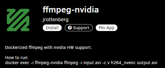

There's ffmpeg-nvidia:
Shouldn't need to care about the nvidia part of things, just support is there if you have the hardware but it should work just fine in software.
OK, perfect then, I haven't used any of the ffmpeg apps and didn't know them. Thank you very much.
