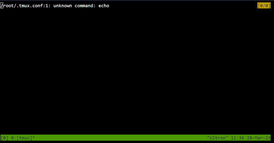

32 minutes ago, Kilrah said:
No, /root, i.e. the home directory of the root user. The USB drive is at /boot.
Okay great cheers. I now have this error though.
nano /root/.tmux.conf
And you add more lines that are indicated above
Excellent thanks 👍
