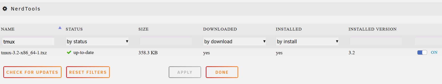

I installed the nerdtools again via the app store.. clicked the plugin, searched tmux and clicked the "on" thing to enable it... now when I load a session and type "mc" I get this error.
Unknown terminal: tmux-256color
Check the TERM environment variable.
Also make sure that the terminal is defined in the terminfo database.
Alternatively, set the TERMCAP environment variable to the desired
termcap entry.
