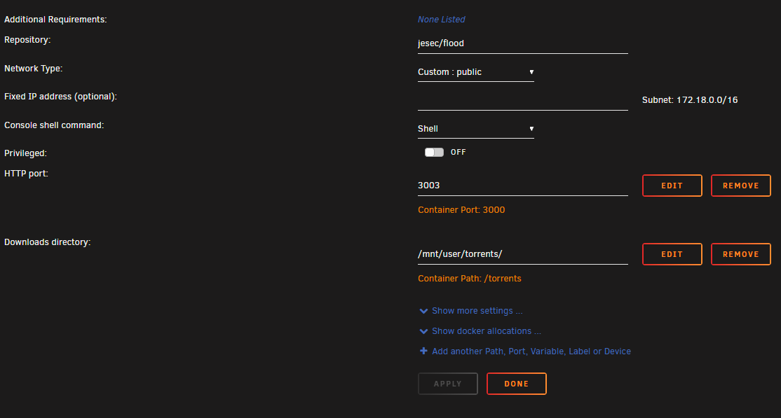

On 3/31/2024 at 7:50 PM, CanadianBear said:
Bummer. At least now I know it's not something I did wrong. I'll stay subscribed to the thread and hope that it gets resolved some day. Thanks for looking into it! I just got VueTorrent going. Looks pretty good, but feels like it's missing a few things I'd like.
I updated the container to use @jesec/flood instead of flood when installing which is supposed to be the cutting edge build aka the github code. Not sure if you are still looking for a solution to this but updating the container should be able to connect with the latest qbit. 😄
Link to comment
Thanks a lot! I seems like I can "connect" now, but it shows "No torrents to display," even thought I have torrents of course. Hmm...
Edit: I should add that I recently went back to 4.6.3 because the next update broke qbitmanage. I'm not sure if that would be it.
Edited by CanadianBear
Link to comment

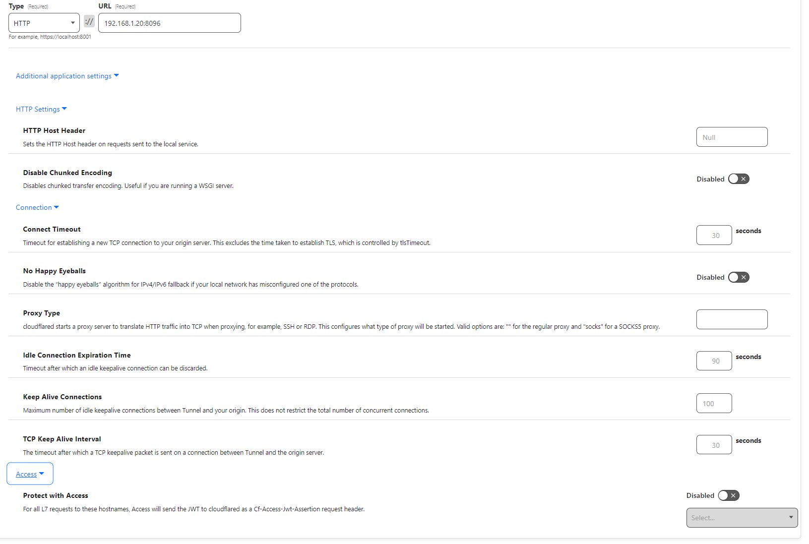

Riddle me this.

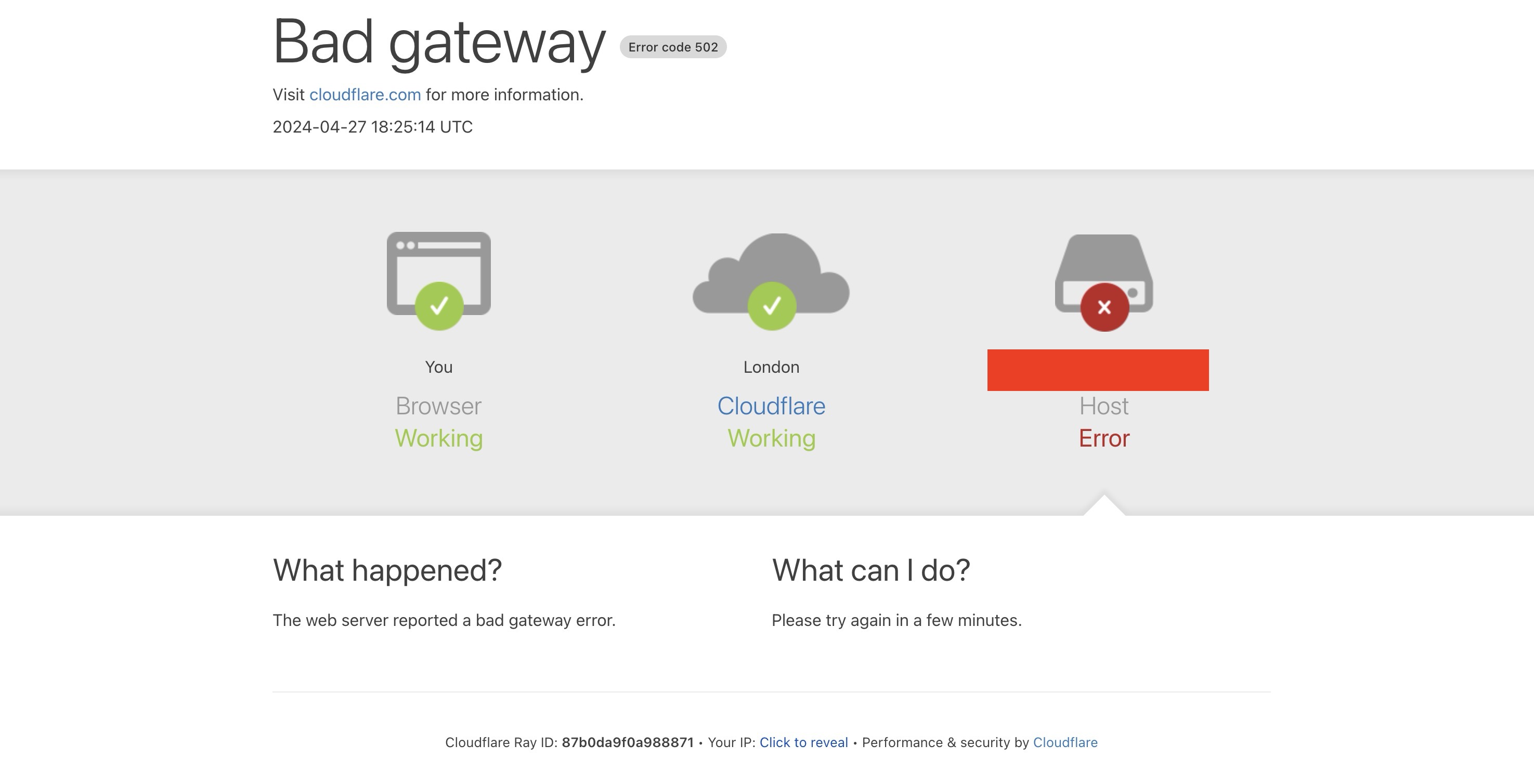

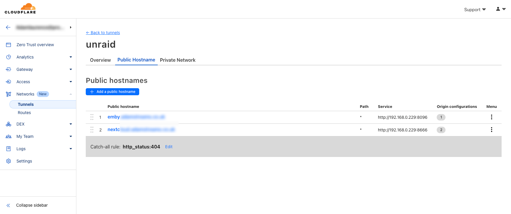

Followed the SpaceInvaderOne cloudflared tunnel video to the letter. Copied the URL it created (when you create a public hostname for a service - in my case, for Emby, which I have decided to set up first before trying Nextcloud) into my browser, and I get:
"This site can’t be reached emby.mydomain.co.uk’s DNS address could not be found. Diagnosing the problem.
DNS_PROBE_POSSIBLE"
Here are some screenshots of my setup
But when I go and click on the Emby WebGUI button in my Unraid console, it connects to Emby, showing [http://]192.168.0.229:8096/web/index.html#!/home in the URL.
I have no idea what I'm doing wrong, missed out (at least based on the video, I followed that along perfectly) or am not considering. Unfortunately I am banging my head against a wall with this, despite it apparently being easier than reverse proxies.
nas-diagnostics-20240427-1836.zip
Link to comment
36 minutes ago, icarus69 said:
Riddle me this.
DNS_PROBE_POSSIBLE"
Hello, I have taken a look at your screenshots. The only part that should matter for this setup is the "Public Hostnames" portion under Zero Trust > Tunnels > <Your Tunnel Name> > Configure
Here are my settings for Jellyfin which is an open source fork of emby from what I can tell. Should be very similar setup
I'm not sure if emby uses HTTPS by default or HTTP but you may have to play around with these. If you use HTTPS try toggling "No TLS Verify" under TLS. The DNS records should be auto created when you make new hostnames under your tunnel. You should not have to edit anything in your DNS records.
Your setup of the tunnel seems to be correct, I believe it is just some of these settings you need to play around with to get this working. Hopefully this helps. Let me know if anything changes
Link to comment
Trying your suggestions:
1. Switching the tunnel from HTTP to HTTPS results in the URL:
700679142_Screenshot2024-04-27at19_26_32.thumb.jpg.ab558bea200207259673e7db32ddbe30.jpg
2. Enabling "No TLS Verify" while using HTTPS results in the same error.
3. Keeping "No TLS Verify" but switching HTTPS back to HTTP... works! Though something to note - clicking on the generated URL that takes me to Emby, despite the "Type" being "http://" in the Couldflare Tunnel page, becomes "https://" when loading the Emby web page..? Is this ok? Why does this happen? Also, what does the "Catch-all rule: http_status:404" mean?
I don't know a lot about this stuff, but should I consider the task of fixing this done now? I don't want to have achieved this via any unrecommended means.
Edited by icarus69
Link to comment

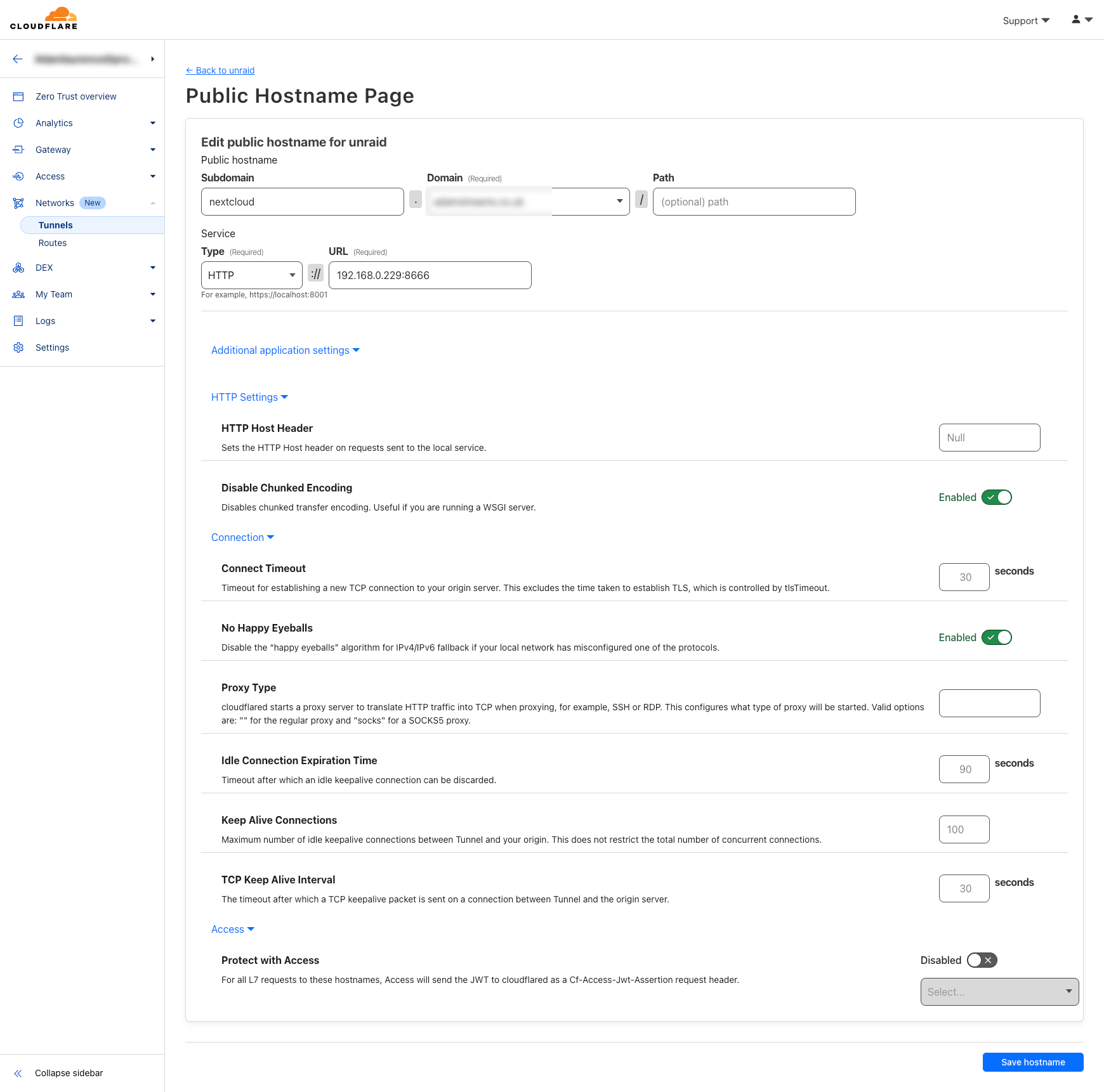

Glad you got it working. If using HTTP there should not be any TLS options under that hostname anymore and the tunnel should be using HTTPS using your cloudflare account's TLS certs. When you visit emby.<your domain> check to see that your browser uses HTTPS and that the cert athority and expiration matches on the cert. I have some examples of mine below. If thats all good your tunnel is secured :). From my knowledge as well these cloudflare tunnels should only allow outbound traffic as well. Hope everything is good!
image.png.9f56073eba3b1ac2490612cfdbfc0aa2.pngimage.png.006b582e28c9c1129cdd02a05f0eb212.png
Link to comment

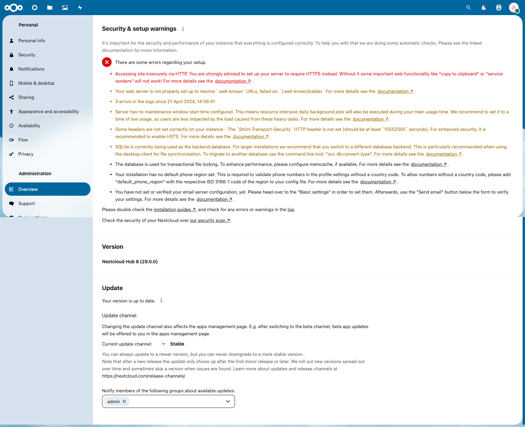

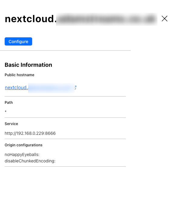

Actually I'm still confused about quite a few things. Forgive me as I'm new.
I still don't quite understand how/why Nextcloud is configured as HTTP in Cloudflare, but then appears as HTTPS in the URL.
Also, I don't understand why the Nextcloud errors page says "Accessing site insecurely via HTTP", when the URL says HTTPS. Remember, I was unable to access the Nextcloud console when settings HTTPS in Cloudflare.
I also just generally don't know what to do about the other errors.
I originally followed along with SpaceInvaderOne's Nextcloud + reverse proxy tutorial. Despite following along perfectly (including his troubleshooting suggestions at the end), I was unable to get it working, and I couldn't find any relevant help.
So then I decided instead to ditch the reverse proxy method and instead follow his Cloudflare tunnel tutorial and connect to Nextcloud that way. This worked (though I have some questions about configuration that I'll save for another post).
Possibly as a result of attempting these two methods, I now have two nextcloud folders in my Unraid server: /user/nextcloud/ and /user/appdata/nextcloud/.
Is it safe for me to delete the /user/nextcloud/ folder? This was the share folder that SpaceIndaverOne instructs you to create as part of the reverse proxy tutorial. But I don't see the same instruction to make one in the Cloudflare tunnel tutorial. So naturally (as a beginner) I'm assuming this means I don't need the /user/nextcloud/ share folder anymore? Or am I missing something about the role that share serves?
Lastly, am I getting played by AI? I've been using Claude AI to try and resolve some of the issues I have, but feel I've reached a dead-end. I'm wondering if I'm being given wrong advice by the chatbot. Here's the chatbot convo.
screencapture-nextcloud-adamstreams-co-uk-settings-admin-overview-2024-04-28-15_03_38-edit.png
screencapture-one-dash-cloudflare-097591b3f748ab8949f8be2d82382681-networks-tunnels-84cdc41a-499d-4d59-a02e-aba9b612e82e-public-hostname-nextcloud-adamstreams-co-uk-1-2024-04-28-15_00_21-edit.png
screencapture-one-dash-cloudflare-097591b3f748ab8949f8be2d82382681-networks-tunnels-cfd-tunnel-84cdc41a-499d-4d59-a02e-aba9b612e82e-edit-2024-04-28-15_01_19-edit.png
screencapture-one-dash-cloudflare-097591b3f748ab8949f8be2d82382681-networks-tunnels-cfd-tunnel-84cdc41a-499d-4d59-a02e-aba9b612e82e-edit-2024-04-28-15_02_09-edit.png
Edited by icarus69

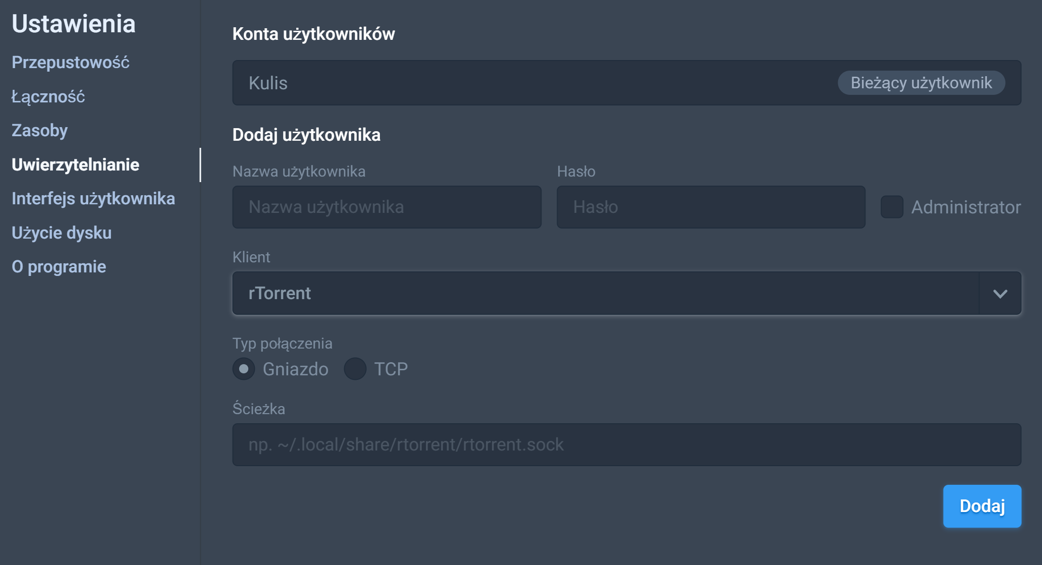

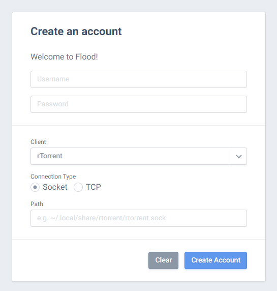

Hello everyone. Can anyone tell me what I need to change in the image settings to be able to connect to rtorrent?
I would like to connect to rtorrent but I don't know what to enter here:
My config docker:
docker run
  -d
  --name='Flood-UI'
  --net='dockerproxy'
  -e TZ="Europe/Warsaw"
  -e HOST_OS="Unraid"
  -e HOST_HOSTNAME="Kulis-unRaid"
  -e HOST_CONTAINERNAME="Flood-UI"
  -l net.unraid.docker.webui='http://[IP]:[PORT:3001]/'
  -l net.unraid.docker.icon='https://raw.githubusercontent.com/AriaGomes/Unraid-Templates/master/Images/flood-ui.png'
  -p '3001:3000/tcp'
  -v '/mnt/user/appdata/rutorrent-crazymax/data/rtorrent/':'/config':'rw'
  -v '/mnt/user/downloads/':'/data':'rw' 'figro/flood-ui'
Polecenie powiodło się!
