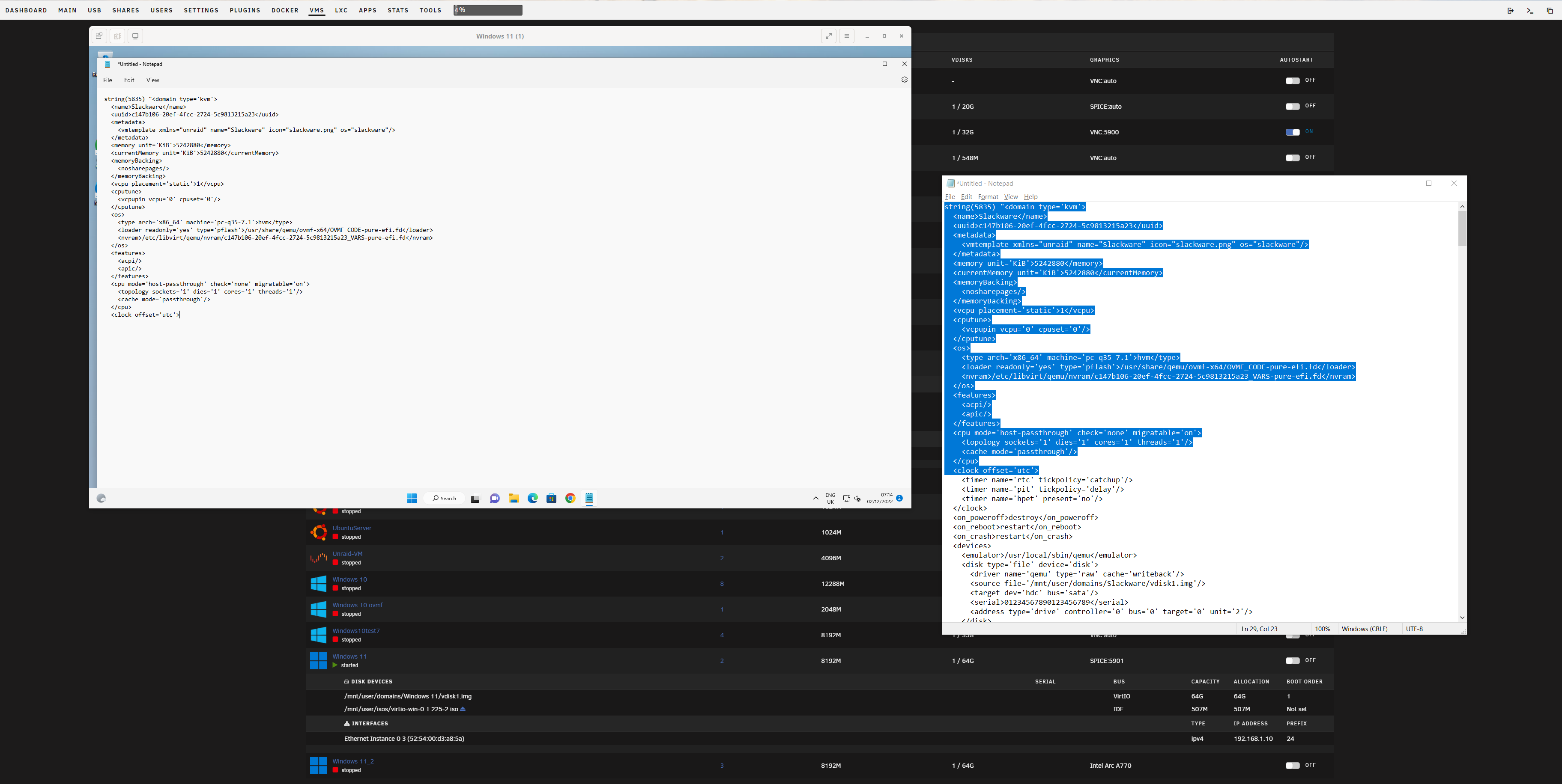

This is my machine.
    <channel type='unix'>
    </channel>
    <channel type='spicevmc'>
      <target type='virtio' name='com.redhat.spice.0'/>
      <address type='virtio-serial' controller='0' bus='0' port='2'/>
    </channel>

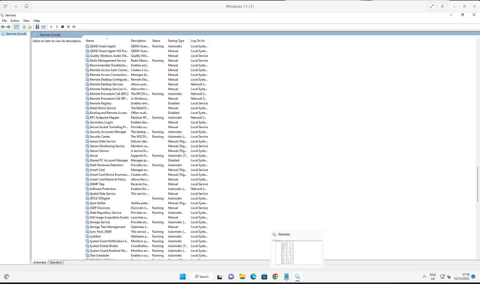

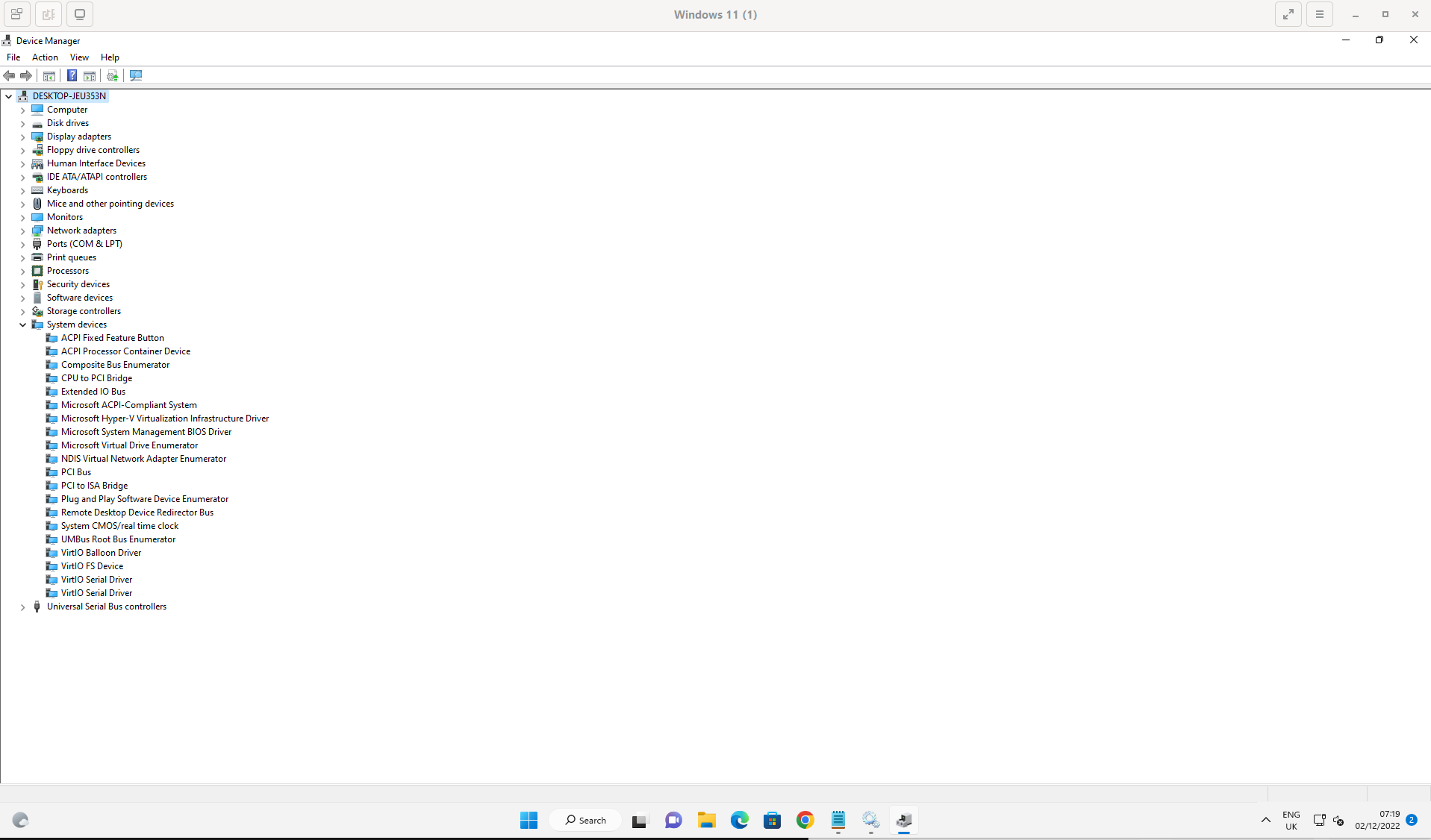

I do have both the qemu guest agent and the spice-vdagent installed.
Edited by SimonF
On 12/2/2022 at 2:10 AM, SimonF said:
This is my machine.
    </channel>
    </channel>
The only difference I can spot is that you seem to have two VirtIO Serial drivers? I only have one.
