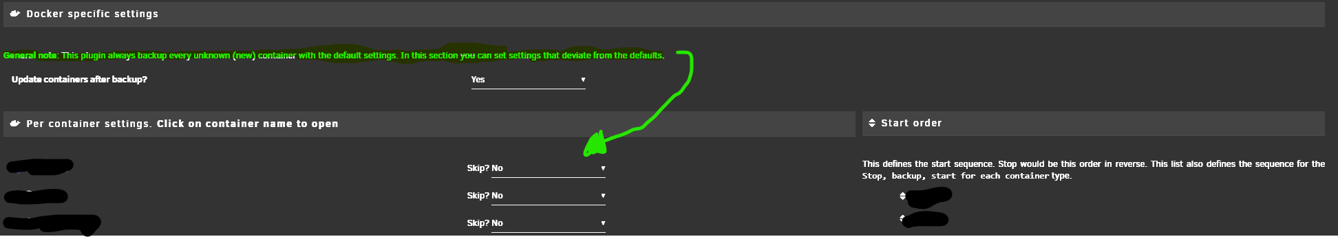

General Note location
Suggest moving this note.

Ambiguity in 'skip'
It's unclear if skip container will skip both the backup and the update, or just the backup.
