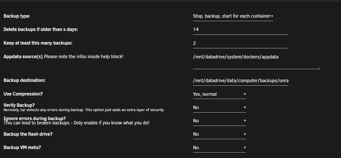

Can i select Backups for Revisions/Points and days?
By rotated Drives is for example 90 days worse than revisions.
Sorry, I dont understand :(
The Retention that I can selected is x Days and not x Points.
Booth Options are very cool.
Than i can choose through Days or Points.
By Days can deleted a job all Backups on a old USB Disk. For example the last used are 120 Days and have 90 Points/Backups the Retention is 80 Days/Points. The Backup Job/Retention deleted all Backups outside the Retention.
Backup Run 2x daily.
By Points the Retention deleted only the Points outside the Retention.
By days removed the Retention more Backups.
Just set more days for retention?
That's an Option when the USB Disk have enough Storage.
But Unfortunately, this does not solve the problem if the other disk was not connected for so long that it is outside the retention and therefore all backups would be deleted there when connecting and backing up. Instead of retention with points only those above the set retention points.
Therefore a choice option would be super. Then one can take days and the other takes points.
Did you try this option?
If you're always doing 2 backups per day then it doesn't matter whether you keep x backups or keep backups for Y days, you can always get the same result. Keeping 30 days of backups equals keeping 60 backups.
Edited by Kilrah
That's its!
I must be blind.
This in combine with the Retention Days.
I tried!
