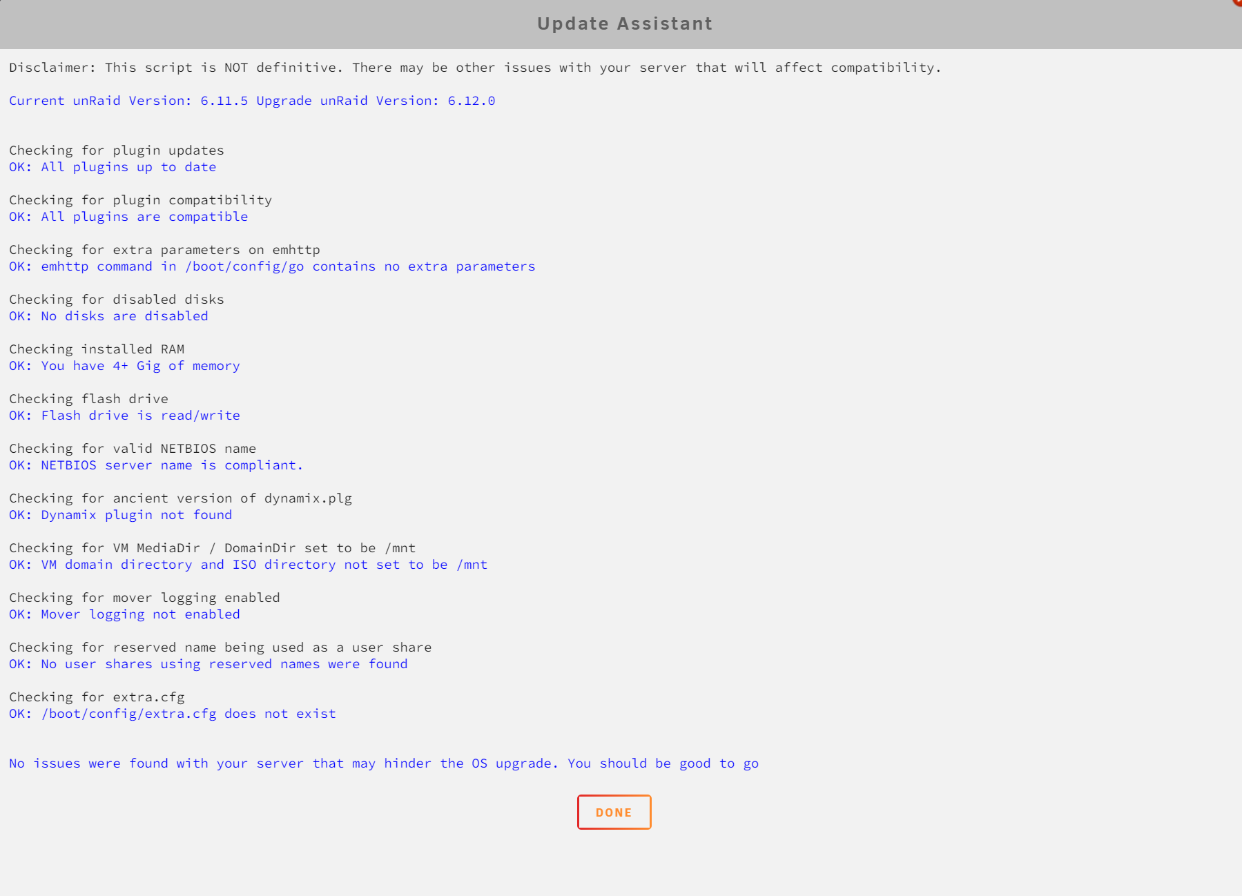

Update assistant doesn't find any issues, I know it is not definitive. But I am unsure what is causing the problem, hence this post.

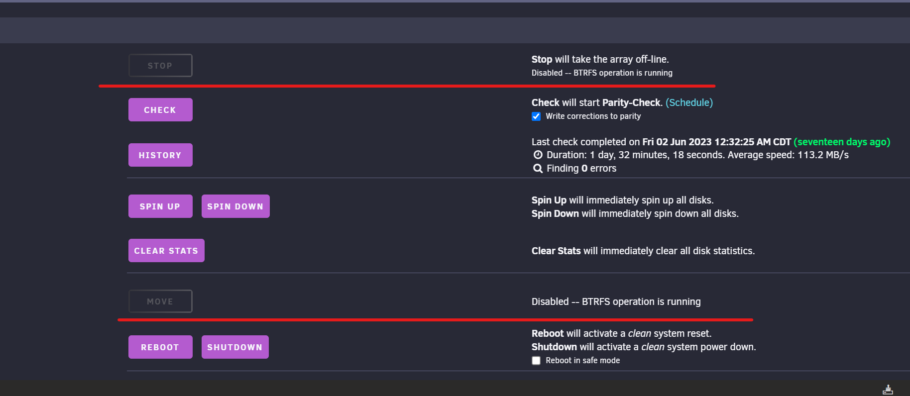

Another thing that just popped up - BTRFS Operation is running. Same as this issue here.  Screenshot below.
21 hours ago, isrdude said:
the same problem
Start your own thread with your diagnostics. Don't hijack.
No btrfs operation going on that I can see, if it doesn't go away on its own reboot.
