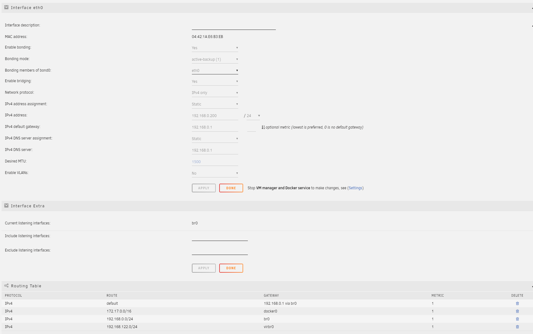

I have 3 servers, 2 upgraded without any major issues but my machine I updated today from 6.11.5 to  6.12.1 and issue I had is with the network.  I was using a USB 2.5g dongle so when it booted up, it didn't ever reconnect, i had to unplug from dongle and plug back into the 1G ethernet on the MB.   Since it's been so long since I did that, I couldn't remember how to get it back other adapter and it was NOT showing in network settings.  If someone can point me in the right direction please.  I remember you to change eth0 to eth1 but I did not see that.. This is what I have in network settings. Not sure why the adapter is not showing anymore
You could try stoping the array.  Set Enable bonding to "no".   Then see if you get any "Extra Interface" that you can assign to your eth0 interface.
1 minute ago, GeorgeJetson20 said:
Nope that did not work, rebooted but the device does not even light up   Shoot, this worked perfect with the 11.5 - Really need the speed.    This is the Amazon part of what worked previously.
https://www.amazon.com/gp/product/B084L4JL9K/ref=ppx_yo_dt_b_asin_title_o01_s00?ie=UTF8&psc=1
It's a Realtek I believe.
This sounds like something that is going to take a bit of back and forth, not ideal for a release thread. Your best bet is to start a new thread and be sure to upload your diagnostics.zip (from Tools -> Diagnostics)

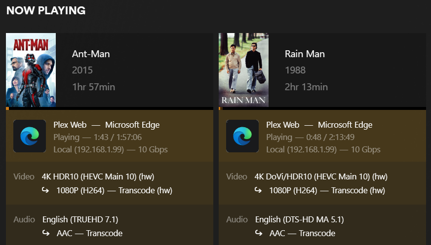

Kind of a feeler post, I'm having issues with transcoding 4k content in Plex, it appears this issue popped some time during the 6.12 release candidate cycle.  No other changes to my setup, I've reviewed all of my settings, no issue transcoding 1080p to 720p/480p etc.   Was curious if anyone else was having similar issues?
Intel® Xeon E-2288G CPU.
In the meantime, I will continue to review my settings, and do more testing.
Thanks.
Thanks.
Same CPU as you, no issues here:
Edited by craigr
Added DV screen shot.
Made a few changes, making progress,  looks like I disabled HDR tone mapping while troubleshooting another issue, re-enabling seems to have made a difference, will continue to adjust and test.
Thanks for responding.

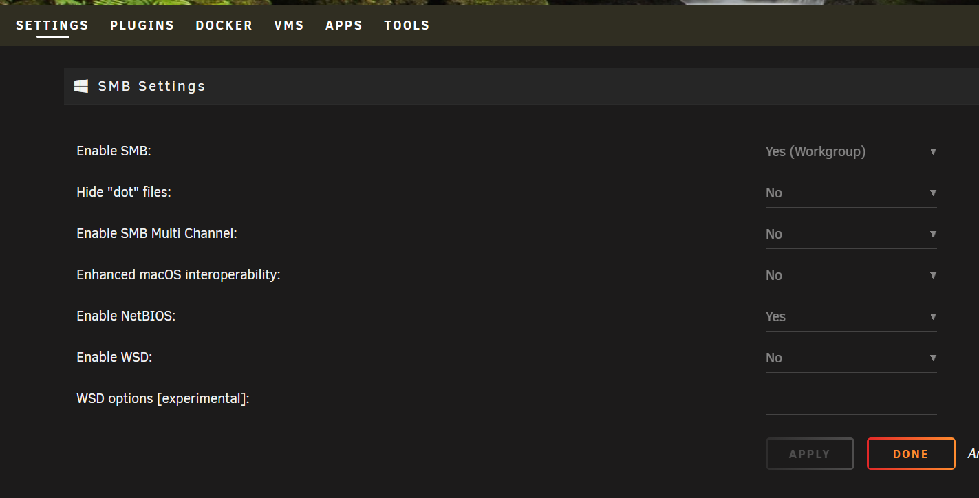

On 6/22/2023 at 11:40 AM, bonienl said:
You need to disable "netbios" to make SMB work over tunnel interfaces.
The service binding to interfaces reveals the shortcomings of netbios: (1) it does not support IPv6 and (2) it wants to use broadcast addresses.
Hence tunnels are excluded from Samba when netbios is enabled to prevent errors.
Thanks for helping me.
Do you mean disabling netbios on Unraid or the ZT/Tailscale interface of the remote device? Removing it on the remote device did not help.
I now have both VPN solutions, both included in "Include listening interfaces", but it still does not work. I really wonder how you got yours to work.
It's in a weird place IMHO:
