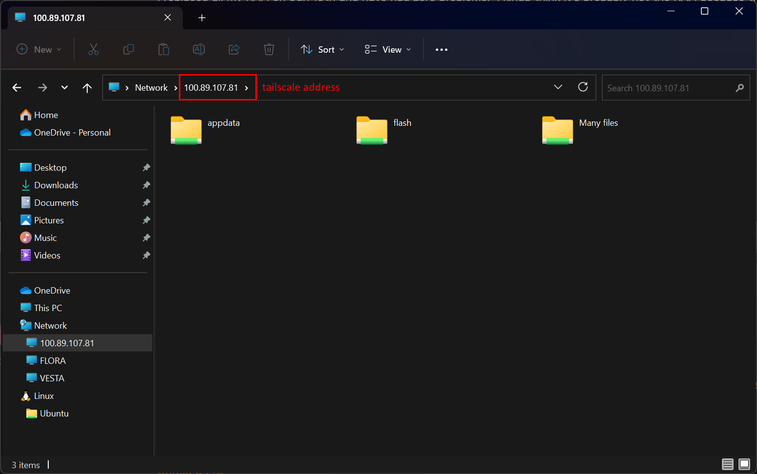

16 hours ago, TBT said:
I use Zerotier, same problems as Tailscale.
You need to disable "netbios" to make SMB work over tunnel interfaces.
The service binding to interfaces reveals the shortcomings of netbios: (1) it does not support IPv6 and (2) it wants to use broadcast addresses.
Hence tunnels are excluded from Samba when netbios is enabled to prevent errors.
Here is a picture of using SMB over tailscale
