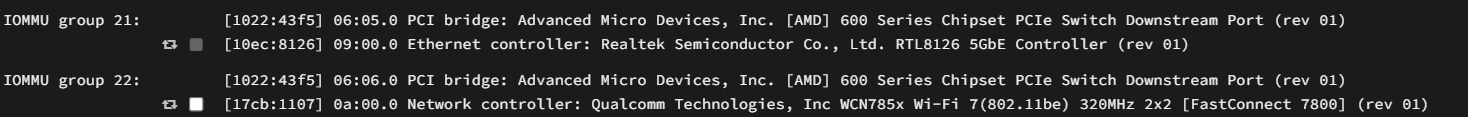

Built a new server for unraid this week, and any help with this, would be much appreciated.
The motherboard I chose is an MSI mag x870e tomahawk, which has a RTL8126 5gb ethernet.
I am testing this new server with a fresh install V7.0.1 trial key to make sure there weren't any hardware issues.
Of course there isn't native drivers in Linux kernel 6.6.78, so I installed the RTL 8126 plugin.

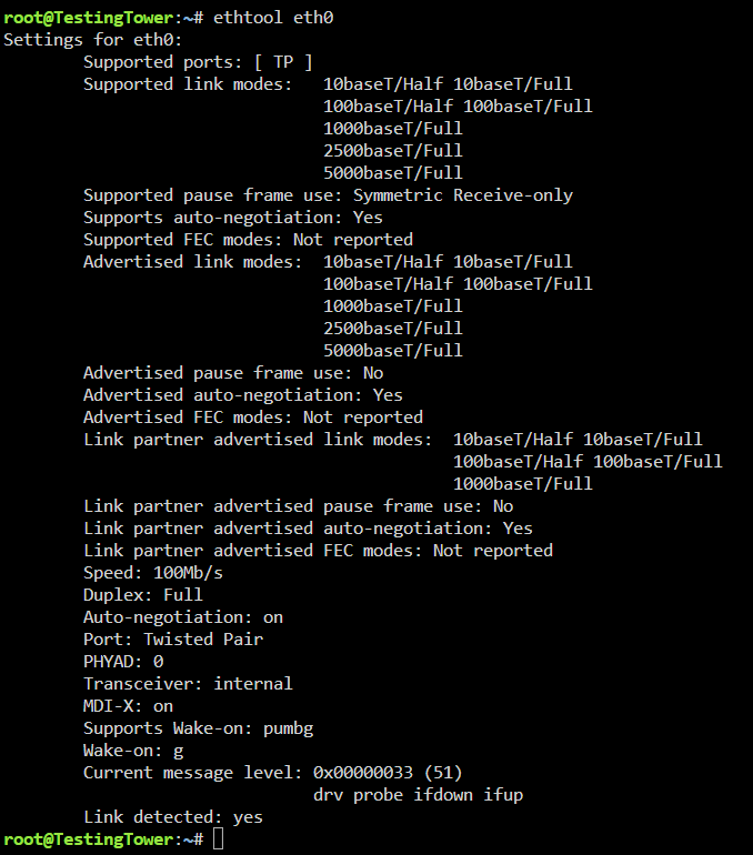

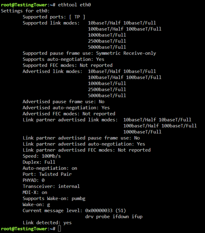

It recognizes the card, but unfortunately will ONLY negotiate to 100MB plugged in to my Ubiquiti US-8-60W gigabit switch.
I have switched ports and switched cables. All cables being Cat6a. I also have my PIKVM connected to the same switch and connects at gigabit speeds. And the switch connects to my US48 Ubiquiti switch at gigabit speeds. So i doubt it's my switch or cabling.
ethtool says the port is CAPABLE of everything up to 5GB.
Curious thing when booting up, is it shows the IPV4 address isn't set, yet I CAN get to the Unraid gui.
I've attached the diagnostics file.
Thank You.
testingtower-diagnostics-20250327-2220.zip
Thank You.

I'll explain my problem better:
A new Unraid 7.1.4 installation
ASUS Prime Z890M-PLUS WiFi with a Realtek RTL8125D LAN chip with a speed of 2.5 Gbps
At first, it didn't recognize the chip, but after reading the topic, I realized I needed to install the drivers on the community application, so I did.
Now the chip is recognized, but I'm getting 100 MB and not 2.5 GB.
I tried to see if I could update the drivers, and I did so via terminal (with the help of a friend), but nope, it's as if they're resetting at every boot.
I tried replacing the drivers in the plugin folder (I noticed it loads those at every boot), but it still doesn't recognize them.
I set the r8125 file as per the forum.
ASPM option = 1
eee_enable option = 0
But every time I set eee=0, it disappears from the configuration.
I don't know what else to do.
driver mountedr: 9.014.01-NAPI-RSS
blacklist r8169
this is my conf by ethtools:
I have no more ideas about it, please help me

how did you solve this? i've same configuration and same problem partially solved with plugin rtl8125 but now i go to 100mb and not to 2.5gb speed
ASPM option = 1
blacklist r8169
i've solved too simple... i've change another cable (3rd cable) with support 5gbps and reinstalled the driver with new cable inserted , now i've full speed (modem unfortunately support only 1gbps but go to 2.5gbps)
cheers, i hope to help someone who have same problem to solve it
