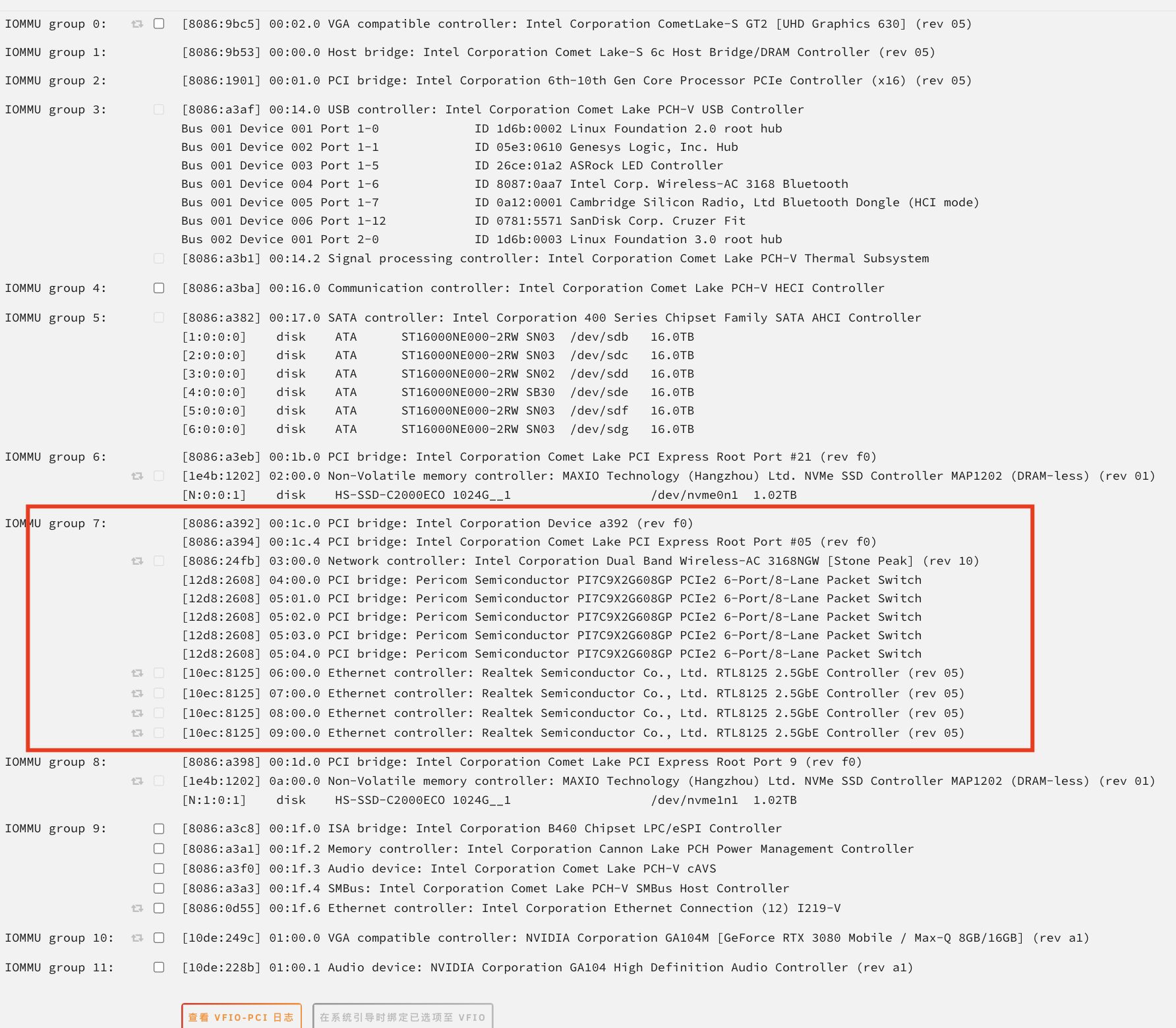

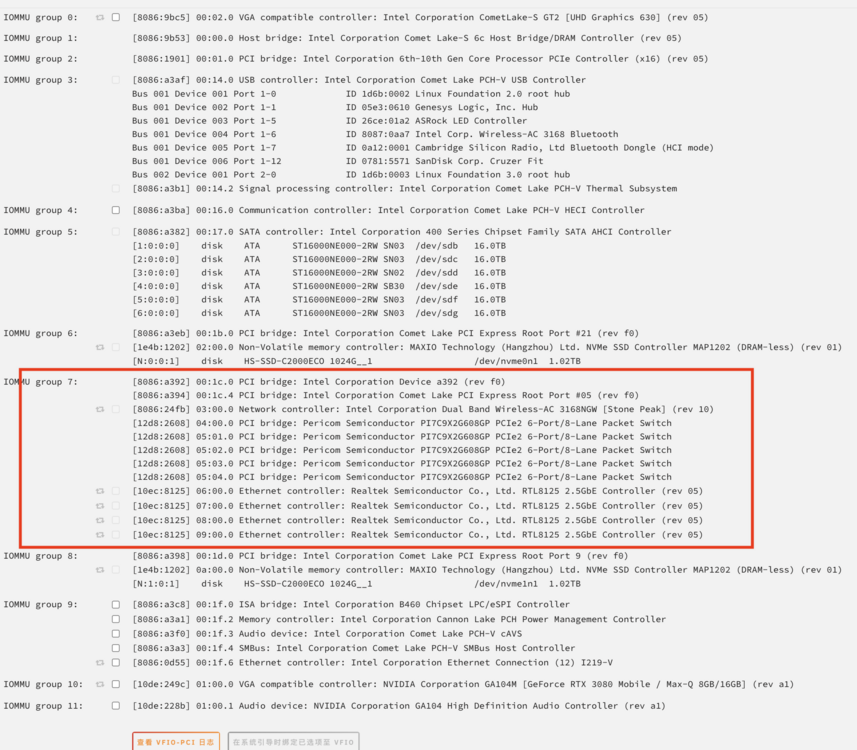

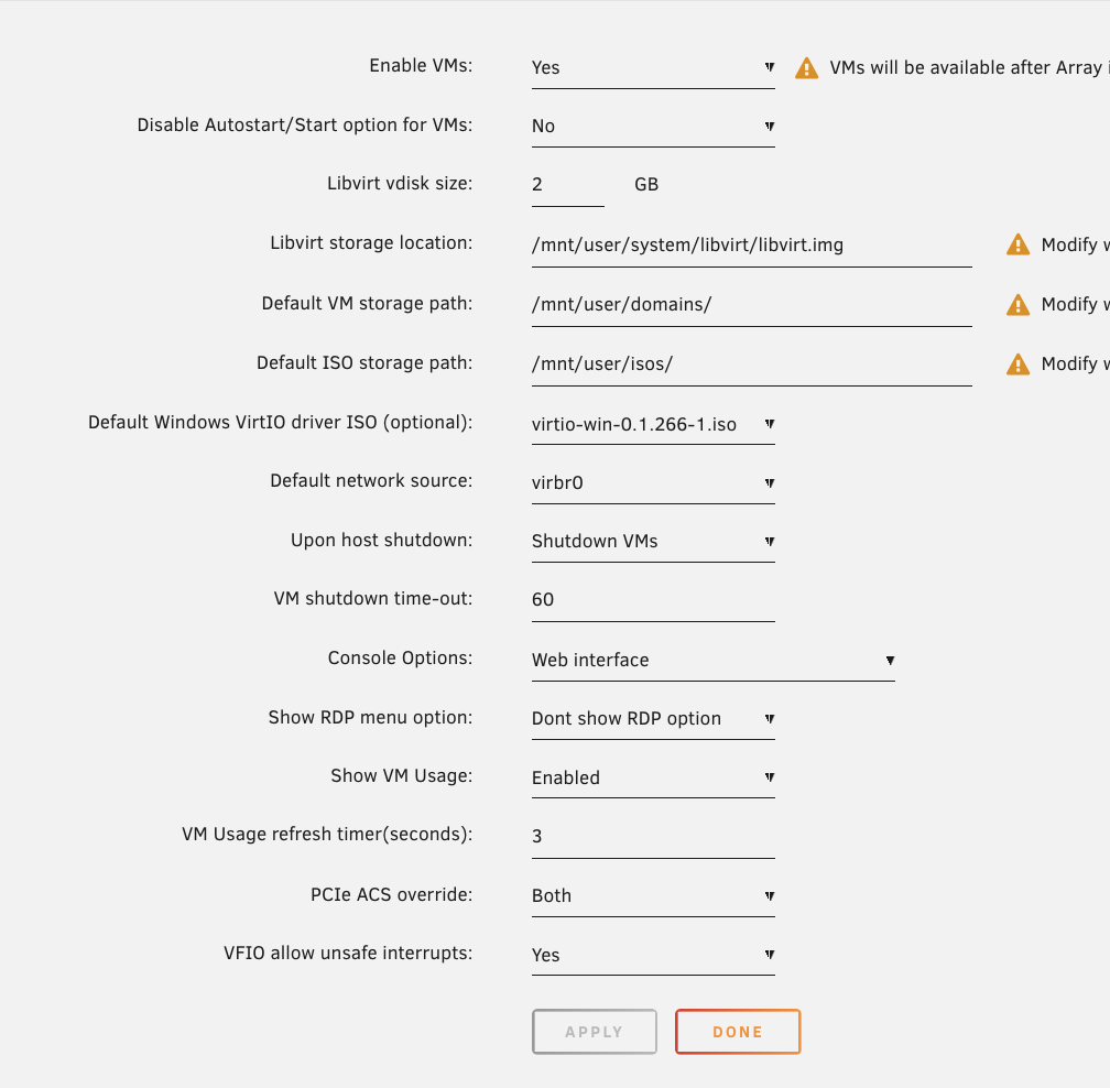

i installed this plugin , and tried all PCIe ACS override methods, but still they are in the same immo group
i just upgraded to unraid 7.0
Some motherboard models won't allow the groups to be changed. Small chance BIOS upgrade or changes may help. If not, different model motherboard may be required.

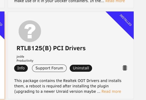

Naively installing the RTL8168(B)/RTL8111(B) PCI Drivers via community apps simply killed my ethernet, so:
What chip do I have (not RTL8168H?) and what drivers I would need?
Github showed a build for kernel 6.12.19-Unraid, so I - maybe also naively - assumed this would work with the current beta.
Any idea where I went wrong here?
