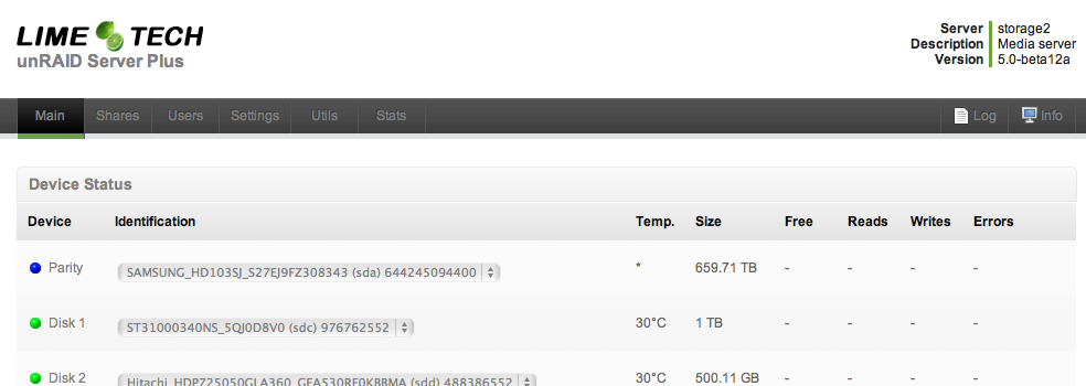

not sure what's going on with my array, but my parity drive is reporting to be 659.71TB..... Yes, really 659.71TB
attaching a screenshot and syslog.
Going to reboot to system shortly.
anyone seen this in the past?

It has been reported once before.
Let us know if a reboot fixes it.  If not, I'd love to see an hdparm command output for that drive.
Joe L.
Joe L.
Thanks for the response Joe L.
after rebooting the system, the drive reports the correct size.  The system views the drive as a new drive so I have to re-run parity check.
