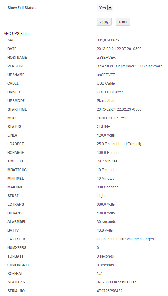

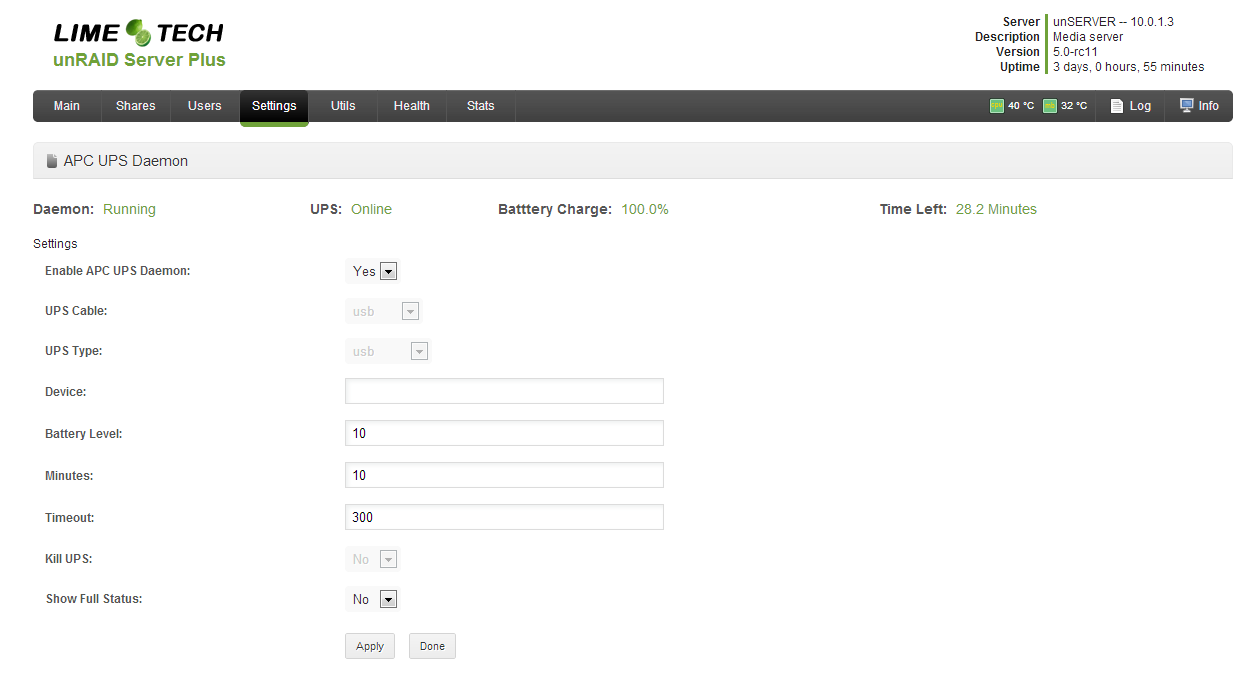

Is anyone else running simplefeatures (1.0.5 or 1.0.11) and this plugin and having this problem:
(Doesn't happen on stock)
Before starting array:
After starting array:
Working for me
hmmm.... mine is not - UPS is unknown and no ups status...
Myk
Well I don't understand whats going on. With the array running I disabled the plugin and then re-enabled the plugin and everything showed up correctly, this time I had show full stats off ( I don't think it really matters...). So while everything was displaying correctly I enabled show full stats and the stats showed up right away (didn't hit apply). Thinking they wouldn't take without hitting apply, I hit apply and bam, ups:unknown. Disable the plugin, re-enabled the plugin (with show full stats on) and everything came up and is displaying fine.
So the chain of events seems to be this. Boot unraid, look at apc plugin stats before starting array and everything is correct. Start array and I get ups:unknown. Disable plugin (hit apply). Enable plugin (hit apply) and it looks to be working correctly.  :o
