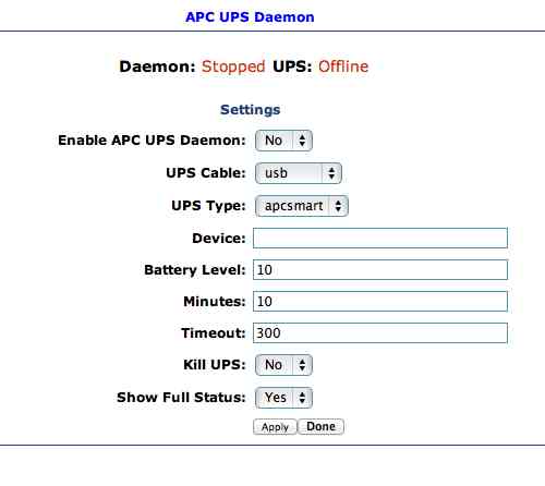

What setting should I use?
My UPS connects with a serial cable, would that be SIMPLE?
What do I put under device?
What does battery level, minutes and timeout, kill UPS and show full status mean?
thanks
Bump
OK, from memory
Cable - simple (or smart, depends on the UPS and cable used) try it
Battery is the % battery remaining when shutdown is initiated (remember spin up of disks will reduce amount left) so e.e start shutdown when battery has 50% remaining
Mins - same as above but how many mins remaining in the battery
Timeout - shut down if power is off for more than x seconds. If left at 0 then it only works on battery and mins remaining. E.G start shutdown when power has been off for 30 seconds regardless of any other setting. sometimes used if you know when the power goes it goes for a long while, or longer than the UPs will last so why wait for other thersholds to be reached, just shut down
Kill UPS - do you want the UPS to shut down after it has done the server shutdown. From memory i think the suggestion here is yes so that the ups is not drained right down when it is no longer supporting anything
The other reason you want Kill UPS set to yes is that if the power is restored the UPS will not return power to the devices connected.
Actually, no...
If you did not ask the UPS to power itself down, and the power outage was long enough to trigger a shut-down of unRAID, but not long enough to drain the batteries of the UPS, then when power is restored to the UPS it will simply start to charge itself, but the unRAID server will not re-start itself.  You'll need to do that manually.
If you set the BIOS to power back on in the "last-state", then when power is lost, and the UPS turns itself off after shutting down unRAID, then when power is restored, the power supply in unRAID will power itself back on (the same as the last-state it was in before the server lost power) and unRAID will boot itself.
You'll never even know if the extended power outage, other than seeing the re-start in the syslog.
Joe L.
