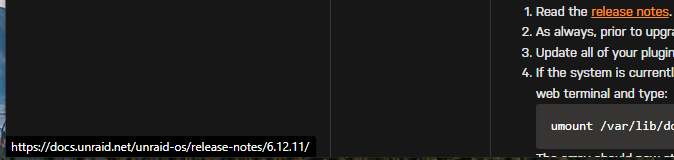

@ljm42  point 1 still points to the previous 6.12.11 release notes
