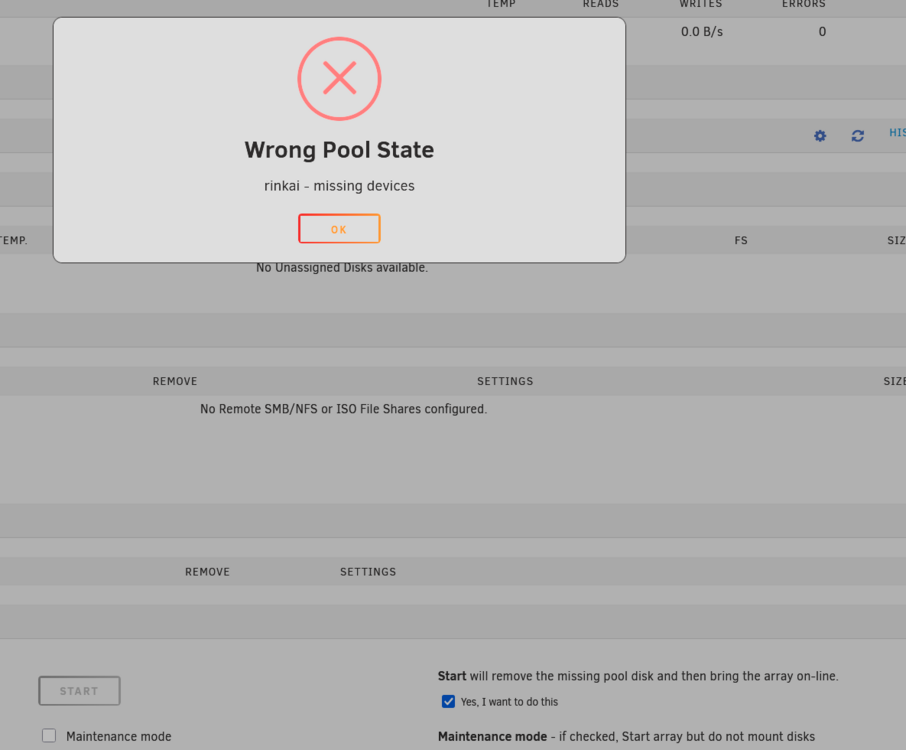

I have a pool disk that I use for my downloads pool that went down and to start the array I can't just check "Yes, I want to do this" anymore... I would have to erase that pool to use the main array and re-create it later when I get a new drive.
If the pool is a single device, this is expected, and it's not the erase button you would need to use; it's the "remove". In case of a multi-device pool, it means it's not being detected as redundant. If it's the latter, please create a new post in the general support forum and post the diagnostics
Mhh curiously enough I was not asked for this before upgrading to 7.2.3 (I was on 7.2) and yes you are right I used the wrong term it is remove and not erase. That being said since that was a single drive pool that I use for scratch and the drive died, I just removed it until the replacement arrives so no worries here.
