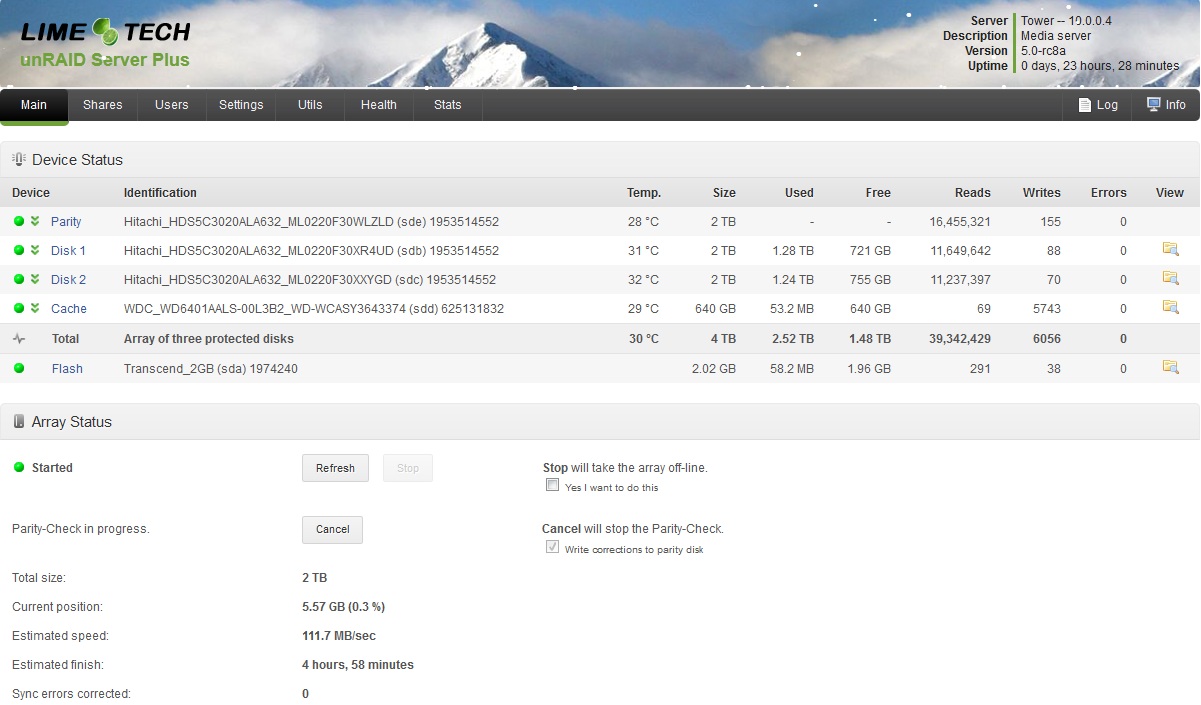

OK this is now just silly.  In an effort to test DoeBoye's theory I did some xfer tests from my PC SSD to my unraid cache.  I saw 65-ishMB/s per terracopy using a 1GB file regardless of governor.  I validated cpu speed with cat /proc/cpuinfo
I then put the governor back to test parity ... and using the ondemand governor this is what I saw (see attached)
At 3.9% now and strong at 115MB/s
