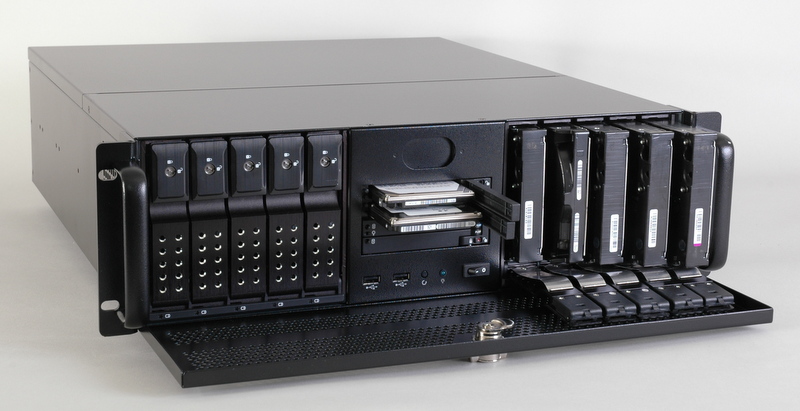

However... We are about to announce (finally) a new server product.  This is a 3U rack mount server with a semi-custom designed chassis made for us by iStar.  This server has been designed for low power and low noise (though not silent).  It includes 80+ "bronze" and "gold" power supply options and incorporates 4-pin chassis fans that can be thermally controlled - most of the time they are spinning slow for low noise.  In addition, the chassis is 19" deep in order to fit into many AV racks.
The 'standard' configuration includes 10 tray-less "warm swap" 3.5" drive bays (warm swap means you can add/remove drives with power on, but with array Stopped).  As an option you can order the unit with an additional 4 "warm swap" 2.5" drive bays.
