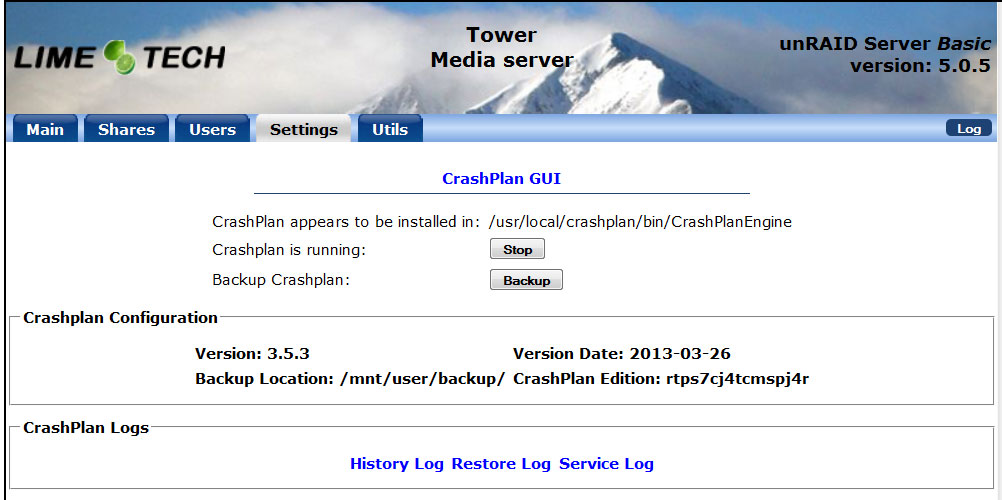

I've updated the plugin for crashplan 3.5.3. The newer crashplan version works fine for me. I also updated the plugin so that it decompresses to /tmp instead of usb key, so that we don't do unessesary writes to our unraid flash.
Personally I've installed jre 1.7 on my unraid and uses this instead, and it seems to work fine with crashplan, and crashplan says it is supported on the web. The crashplan package will still install the old java 6_25, which is probably just fine. I havn't changed the plugin regarding java, its just info.
Note that if you backup lots of data then you need to increase memory for crashplan. It uses roughly 1 GB ram for each 1 TB under backup. Edit the file crashplan\cp_bin\bin\run.conf and change -Xmx512m to like -Xmx1024m. See this post: http://crashplan.probackup.nl/remote-backup/support/q/keeps-stopping-and-starting.en.html
Best, Alex

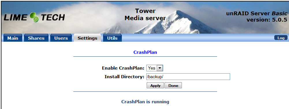

Thanx for a great plugin. But I am confused :)
Used crashplan om my computer, with a subscription for a half a year. Now I would like to use it on my unraid server. (Just 2 disks now, need to buy more to get a cache drive)
Installed to /backup/ and it is running. "backup" is a share spread on the 2 disks.
This directory I understand is /mnt/user/backup ?
But the CrashPlan GUI icon (see picture) tell me something else...
It backup from my computer to the cloud and to "Tower" but when open a tunnel and login to the GUI I entered my key, and clicked yes to transfer the account, and erase the backup I had there.
But when starting to backup to the cloud on my unraid, it only say 185 MB files, instead of 2.4 GB of files, it say it backed up to "Tower".. so I think I only send the install files or something to the cloud, and not my backup-files from crashplan :)
Is there a dummy-guide somewhere? :)

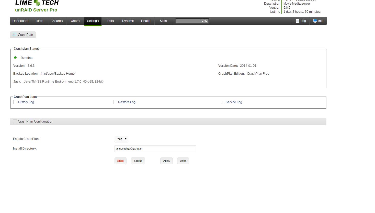

New Crashplan 3.6.3 merged with the gui plugin
best way to install is
remove previous crashplan plg and crashplan gui plg from /boot/config/plugins
add the new Crashplan.3.6.3.plg to /boot/config/plugins (rename the download from Crashplan.3.6.3.plg.txt to Crashplan.3.6.3.plg)
rename your backup in your install dir from crashplan_backup.tgz to crashplan_backup.old
rename cp_bin folder to CP_bin.old
installplg /boot/config/plugins/Crashplan.3.6.3.plg
this will take some time as he will download the new crashplan package
go to the webpage in your GUI
check the installdir if it is correct
enable the plugin
start the plugin
BE AWARE he will download a new Java version which can take a long time to download
look into /boot/temp and you will see the java version .... when you refresh you will see it grow slowly in size ... i think it should become about 32mb
when the /boot/temp dir dissapears then it is completely installed
you should have a window like the one attached
if you want you can delete the old backup and the old cp_bin folder
you can still change the serviceport in c:\Program Files\CrashPlan\conf\ui.properties
so after the installation set the serviceport -> open putty with the port forwarded - > double click on the crashplan tray icon
wait till server window opens
select existing account
add your credentials
IF necessary select which server he needs to adapt too .... (weird one this... on one of my servers he asked to choose which server he needed to take over,  on the other server he took the right account right away)
And all finished
