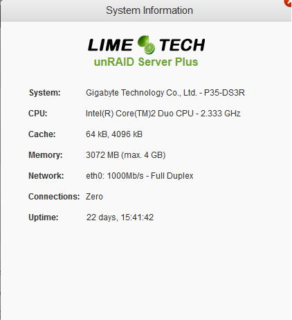

FYI, v5.0 is now running for 23 days 24/7, no problems 8)
ditto (-1 day).
