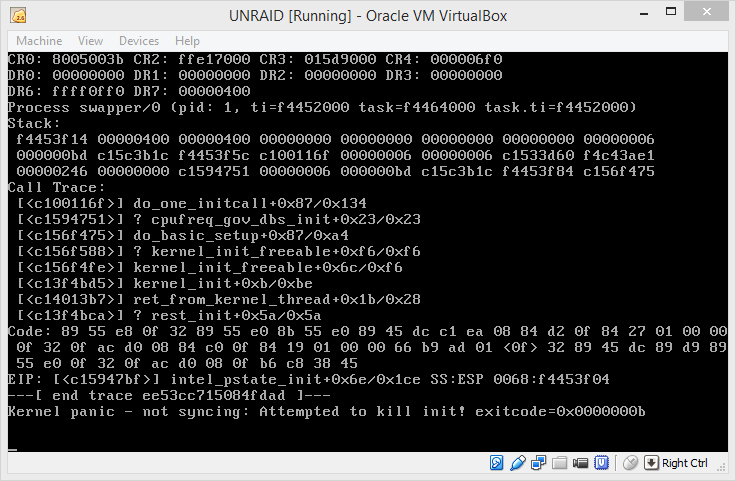

Performed the upgrade on a VirtualBox instance running UNRAID 5.0.0 and it kernel panics every boot.
EDIT: For those who were concerned, this should be an issue related only to the VM.
EDIT: I installed 5.0.4 on my main UNRAID server (non-virtualized) and no issue

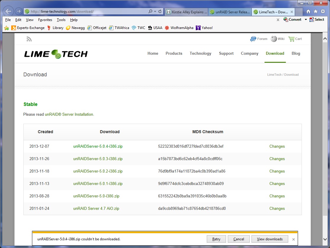

<Sigh>  Just FYI, the download issue is still there ... at least for the one I just did.
It DID download okay when I clicked on Retry ... although not really fast (didn't time it, but probably ~ 20 seconds or so).
Give it another try.  If you have the download page already in browser, refresh first.  BTW 20 sec is not bad.

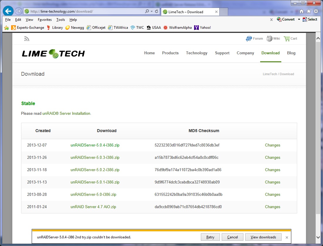

Closed the browser; went to Limetech site; refreshed; clicked on the download; selected "Save As" and named it "... 2nd try" ==> exact same results.
Clicked on Retry and as before it downloads just fine (timed it this time -- 23 seconds)
Used 7-Zip to "Test archive" for both downloads and they test fine, so I'm sure they are.
