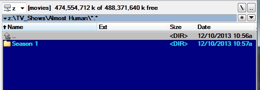

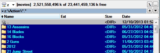

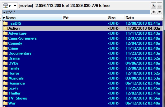

on this release i seem to have a small issue, when i am in the root level of all the main share my free space shows 3tb but when i go into a subfolder it drops to 2.5tb. i also have a cache drive of 500gb so it looks like it is subtracting that space from the total available. the other issue is if i copy a new movie over and go into that subfolder it shows my free space of the cached drive not the total array. to troubleshoot this i moved back to 5.0.3 and it worked as expected by showing the free space of the total array no matter what folder i was in.

How are you doing this?  e.g., via console shell commands, on windows network window, other?  ie, how can I reproduce?

sorry I guess that would help  :).
i am on windows 7 machine with a mapped drive to a share called "movies" that has all my subfolders. the program i am using is Total Commander. attached is some pics showing the sizes...
thanks
James
