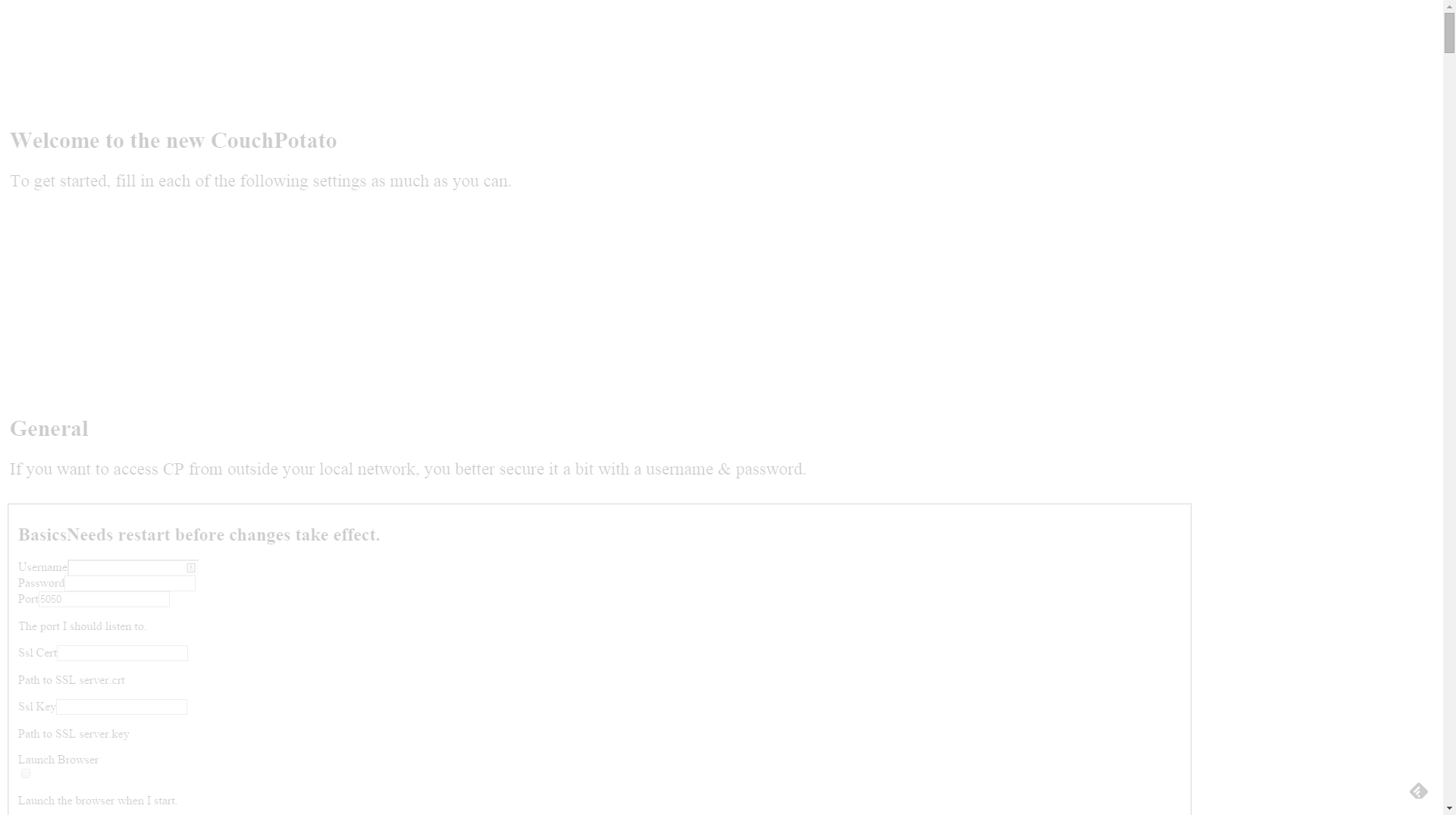

Thanks for putting these all together PhAzE!  I've been meaning to get CP working again. I'm having a little trouble. The install went ok, but when I try to go to the wizard, there's basically no styling of the user interface. See attachment.
It's installed to /usr/local/couchpotato
Config on /boot/.custom/couchpotato
Any ideas?
Any ideas?
Another user had a similar issue a number of pages back. I believe it was a conflict of dependency. What other plugins do you use? unmenu?  You can try removing everything from your usb/packages folder, and rebooting, then selecting a different port for couch potato.
Hmmm, it looks like I did install unmenu at some point, but I haven't used it in forever. I also have MyMain.  So I can just go to that folder and delete everything and it won't have any negative effects?
Correct, because all of the plugins that you use after a reboot will re-download their dependencies, any plugins you don't have anymore will obviously not redownload them. It's like a folder cleanse.
