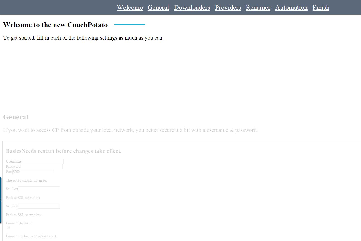

Oops, it's been a while since I last asked my question. But I finally got around to deleting everything out of the flash/packages folder. Cleaned it up a lot, but it didn't fix the issue with CouchPotato (see attachment).  There is still an unmenu folder in the root of the flash drive. Could that still be a problem? How do I get rid of it?

I'm not sure on how to delete it, but you can just change the port if it's still giving you an issue.
