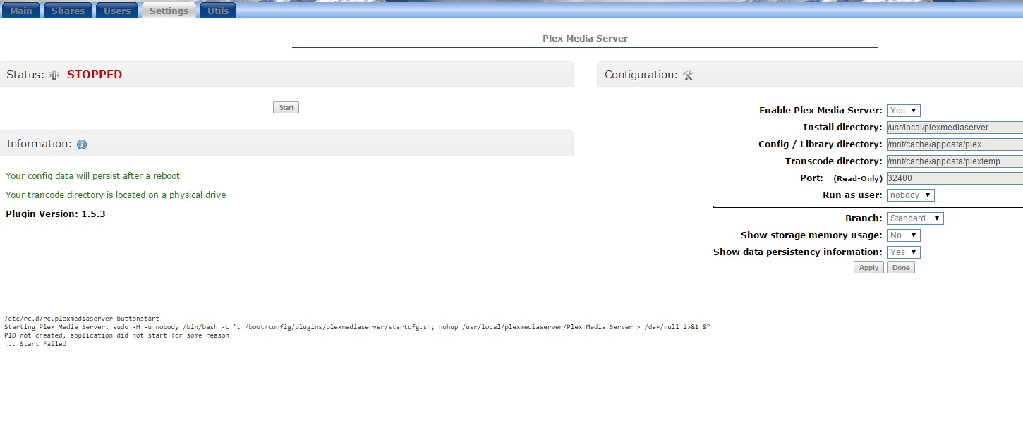

Hello All,
i have successfully installed multiple of the PhAzE plugins with no issue however, when i attempt to install and start Plex, it fails with no real errors in the syslog. I have never installed plex before so i don't have any old files that's needed to be removed/cleaned
[installing the plex Plugin]
root@SERVER:~# installplg /boot/config/plugins/plexmediaserver.plg
file /var/log/plugins/plexmediaserver: successfully wrote INLINE file contents
plugin successfully installed
[starting the plugin]
Nov 30 14:00:18 SERVER sudo:    root : TTY=console ; PWD=/ ; USER=nobody ; COMMAND=/bin/bash -c . /boot/config/plugins/plexmediaserver/startcfg.sh; nohup /usr/local/plexmediaserver/"Plex Media Server" > /dev/null 2>&1 &
Nov 30 14:00:35 SERVER sudo:    root : TTY=console ; PWD=/usr/local/emhttp ; USER=nobody ; COMMAND=/bin/bash -c . /boot/config/plugins/plexmediaserver/startcfg.sh; /usr/local/plexmediaserver/"Plex Media Server" --version
[settings]
Instal Dir: /usr/local/plexmediaserver
Config: /mnt/cache/appdata/plex
Transcode: /mnt/cache/appdata/plextemp
port: 32400
Run as: nobody
Branch: Std
Show Mem: no
Show data: yes
Your config data will persist after a reboot
Your trancode directory is located on a physical drive
Plugin Version: 1.5.3
See screenshot for start screen and error
