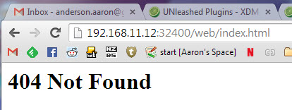

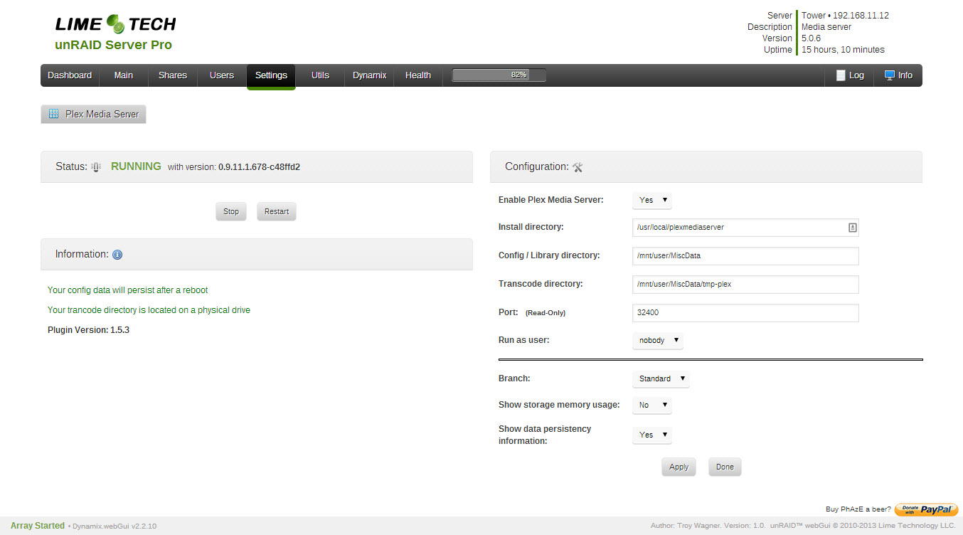

Installed the plex plugin... Settings screenshot attached. I get "404 Not Found" when I go to "http://tower:32400/web/index.html"
Click the word "running".
Or replace the word " tower" with the IP is your nas. It's likely just not resolving the DNS, happens on unraid sometimes.
I have tried both; Same 404 error. If I skip the /web part I do get the XML data, however.
It's a 404 from  the webserver, not the browser, name resolution works fine here... any logs I can look at or provide?
does it load if you set everything to the default directories?
