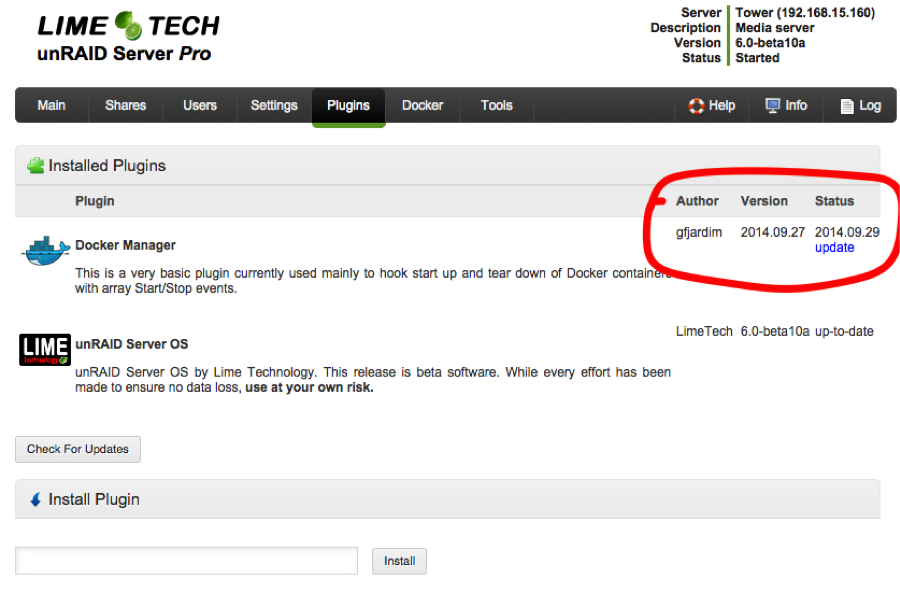

"Deprecated" maybe?
That being said, is it safe to remove everything that shows up down there, without having any issues on a reboot?
Totally reasonable request (on the plugin prompt to remove). We are aware of the bug with "stale" plugins.  The other half is that the idea of "stale" is a little confusing in and of itself. We will address.
Maybe "Updated" instead of "stale"?
Errrrmmm ... "Superseded"?
Before I updated to 10a, version 10 showed I only had one single plugin (unRAID Server OS).  After upgrading to 10a the old docker manager plugin seems to have "come back" and says it's out of date.  Should I update it or delete it?
It means the 'docker manager' plugin on the limetech github is newer than what came with the release.  Sure you should upgrade.
Got it - thanks for the lightning response
