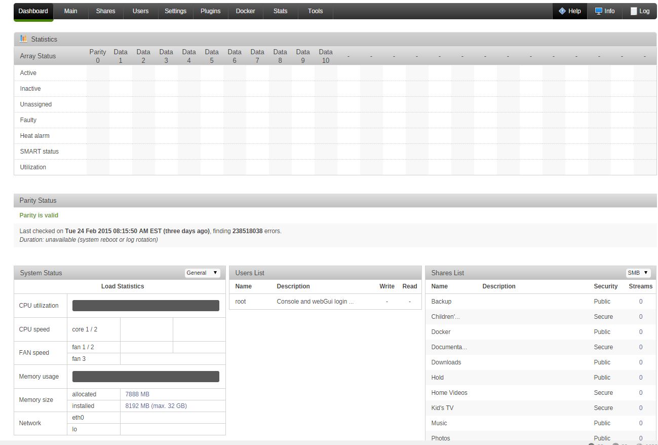

I asked in the 14b thread,but thought I may get additional help here.  I started with v6 on beta 14, stepped to 14a and now on 14b.  I have installed the plugins here, but I don't get any info on the Dashboard page.  Am I missing a step somewhere?
Can you put a picture of your dashboard page, it isn't clear to me what exactly is missing.

Sure - it's just not populating statistics for anything.

I suspect there is some conflict situation preventing the dashboard to display properly.
I advice you to do the following:
1. Make a copy of the content of your flash drive, in case you need to preserve the content
2. Delete the following directories (if existing):
    - /boot/config/plugins
    - /boot/plugins
    - /boot/extra
3. Remove extra installations - if any - from the go file, just have emhttp started.
4. Reboot your system, and it will come up with no plugins
5. Make checks
6. Install optional plugins one-by-one and verify afterwards

Done - no change.

Done - no change.
and clear your browser cache.

Done - no change.
Thanks, but still no dice.

Done - no change.
Just to confirm, after you did step #3 and rebooted (at that point, there was no plugins or anything else running),  the dashboard still wasn't populated with the drive status?
As a stupid step, next to System Status, switch the drop down from General to Errors and see what happens

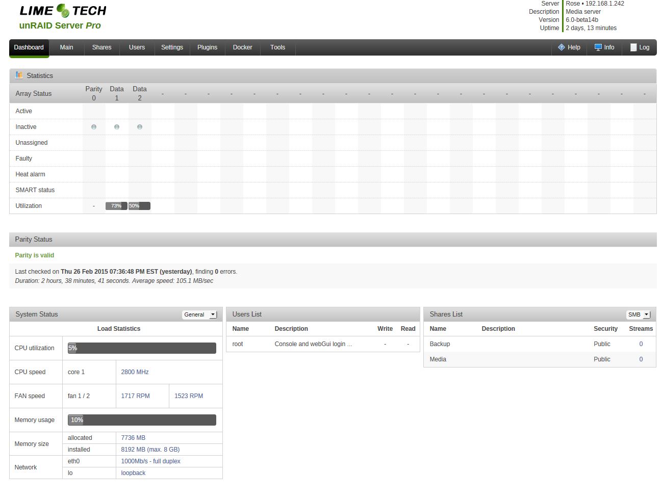

Jon ----
This is what my Dashboard screen looks like.  Describe what you have or don't have in terms of this one.

Done - no change.
Have you tried a different browser ?
Ok. This is off the wall but I have a hunch. Disable UPS in the UPS settings and reboot.
EDIT:  Sorry, set Start APC UPS Daemon to no.

I have tried 3 browsers.
APC plugin was actually stopped, so it obviously was not that.
In comparison to the image, the only discovered info my Dashboard displays is the amount of memory installed and allocated - no other values are present in their respective panels.
Switching from General to Errors to Counters does nothing.
