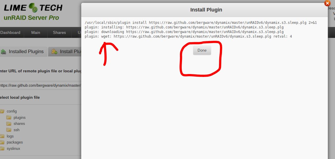

I need some help these wont install and I believe I have remnants of V5 stuff in my plugins folders I have been running V6 14B for awhile and it works fine other than trying to get plugins or docker stuff running which I cannot get either or working.
Basically I am an all stock setup and want to straighten out my plugins folder to stock can someone point me in the right direction of what files and folders need to be in the boot/config/plugins so when i start over / delete stuff I can still get to the web gui / dynamix in 14B and install a plugin..
thanks for your help in advance
aj

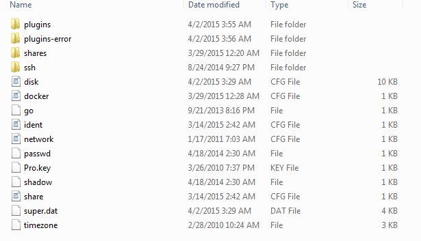

Hi Frank - I know whats on the flash drive and what files are in every folder on the drive....
My question is this -
1. Can I delete all of the items in the Plugins folder or will it hurt Dynamix for V6 B14 (which is built into V6 B14)
2. Then i SHOULD be able to install plugins and get Dockers working etc - In theory!
3.  I looked at your guide and # 4 says - 4.  Now copy the contents of the 'config' directory from your back up of version 5 that you made earlier to the  version 6 Flash Drive.  (You will have to grant permission to overwrite some of the files that are on the Flash drive!) Delete the 'plugins' and 'SimpleFeatures' folders if they exist.
4. Do i delete the plugins folder or whats in the plugins folder?- I believe just whats in the plugins folder - Again just dont want to hurt Dynamix thats built into V6B14 (Question 1) then i will not be able to see the server from my Win7 machine...
thanks
AJ

Assuming you have a VIRGIN ver 6 'config' folder, the only things that I copied over were the files in the root of the 'config' folder and the 'shares' folder.  When I boot up the Flash drive, all of the basic server services were running with proper server name, IP address, user shares, all SMB and NFS settings.  Everything!  What wasn't there were some of the functions that had been added by the plugins that I had installed.  Many of those are available in the two links in steps 8 and 9.  Many other functions that used to be provided by plugins are now provided by Docker containers.  (I don't (and have never) used any of these types of plugins so I had no need to install any Docker containers at this point.)
In retrospect, I believe I will go back and revise the instructions to more fully explain exactly what I did.  I was attempting to follow closely what Limetech had proposed and I can now see where that is going to present a problem!

Frank its not Virgin - I came from 4.7 Pro - 5.xx and Now 6 B14, So I have included a couple screen shots of my flash drive...
1. Inside the config folder
2. Inside the config/plugins folder
I would like to start over so i can get some plugins or dockers working but dont want to delete something in the plugins folder that might keep me from accessing the server from my windows pc..
First thing, did you make a backup of your Flash drive BEFORE you installed ver 6b14b?  A backup will allow to recover anything that you MIGHT need for ver 6.  But it is highly unlikely, you will need anything from ver 4.7 or ver 5.0.X plugins folder in ver 6!  Most of those plugins either don't work or cause problems when used with ver 6!
Second thing, if your answer was "No", make the backup NOW.
Third thing, Ver 6 appears to the outside world exactly the same as ver 5.0.X. as far as access goes (I don't know about ver 4.7 as I never used it).  If you copy over the config files and 'shares' folder, everything will appear normal on your PC.  As I stated in the thread, the basic setup that had to be set up when you first install unRAID back when you first started with unRAID (Server name, password, IP address determination method, etc.) are all in those files.  Even your share share settings should be working.
Fourth thing, IF you should happen to have a problem.  you can always reformat the Flash again, restore that BACKUP that you were told to make and you will be right back to where you were before you reformatted your Flash drive to install ver 6.
Fifth thing, I see an 'ssh' folder in your 'config' folder.  I know what ssh is but I have never seen the need for it so I am totally unfamiliar with its implementation requirements and software that has to be installed to run it. You will have to look elsewhere for an answer to questions about ssh if it absolutely necessary that it be installed whenever your server is on line.

Frank I made a backup on every upgrade because of paranoia while upgrading, Made another one last night and tried a test
1. backed up flash drive
2. reformatted flash drive
3. copied over all from the backup
4. Deleted all the plugins in the plugin folder
5. run the make bootable
6. install flash drive and boot up server
Boots fine and all parity etc shares all fine, went to the flash drive and it added the dynamix folder per V6 B14 uses it now.. went to install one the plugins and it still will not install...  I have included a screen shot of whats happening.... could it be that the server DNS settings are wrong?  see the screen shot its like it downloads i guess ... I click done and nothing , I check the plugins nothing in there for the required plugin, I click the update button 1- 2 times nothing happens...
I am confused.... :-\

The screenshot ends with a failure in wget (download failed). Check that your internet connection is working properly (DNS and IP settings).
As a piece of information, I had to turn off the "Obtain DNS Server Address Automatically:" (on the 'NetworkSettings' page) at some point in the distant past and enter The IP addresses for a couple of IP addresses of DNS servers.  (Probably because I have set Static IP addresses for both my servers.)  You could easily use the Google DNS servers:
The Google Public DNS IP addresses (IPv4) are as follows:
    8.8.8.8
    8.8.4.4
I looked at screenshot of the display and there is not evident to me (or the OP) that anything had failed.  Could you look at modifying the 'Install Plugin' app to indicate an "install failure" if any installation should failed for any reason?  If you could provide the reason that could be an even a better solution...
In the newer version of the plugin manager a "failed" message is displayed, hopefully this makes it clearer.
That should do it!!!  (And, thanks again for all your time and effort in fine tuning the code for  Dynamix to provide a very pleasant, friendly, easy-to-use Interface.)
