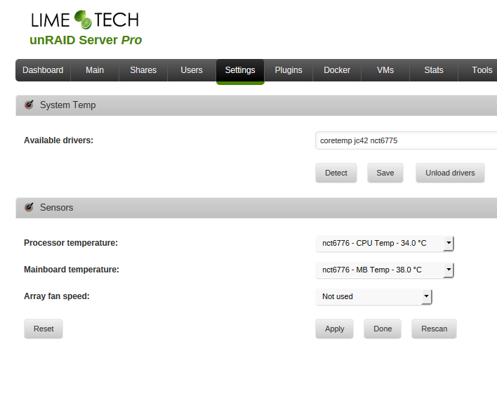

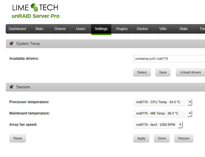

System temp plugin - every time I reboot I loose the "Arran Fan Speed" setting and have to set it again - otherwise no RPM next to cpu/mb temps
Any idea why?
What is the content of the file /boot/config/plugins/dynamix.system.temp/sensors.conf before and after you reboot, did it change?
It should have a reference to the fan allocation, e.g.
chip "nct6776-isa-0290"
label "fan2" "Array Fan"
-- Before --
# sensors
chip "nct6776-isa-0a30"
ignore "temp8"
ignore "temp9"
ignore "temp10"
ignore "fan1"
ignore "fan2"
ignore "fan4"
ignore "fan5"
label "temp2" "CPU Temp"
label "temp1" "MB Temp"
label "fan3" "Array Fan"
-- After Boot --
# sensors
ignore "temp8"
ignore "temp9"
ignore "temp10"
ignore "fan1"
ignore "fan2"
ignore "fan4"
ignore "fan5"
setting1 - after boot
setting2 - what I need to change it to after boot
Thanks
Myk
Not sure why it is not picking up the fan setting, need to investigate ...

I installed the system temp plugin but when I tick the detect button nothing happens. Any idea?
You need the perl package, it has been removed from unRAID 6 final.
Download it from here and save the package in /boot/extra
Either reboot your system or do a manual installation using 'installpkg'.

Once on the temperature settings page turn on Help, which gives you more background information. Btw Help is now available for many pages and settings, make use of that!
Basically do: Detect -> Save -> select sensors
