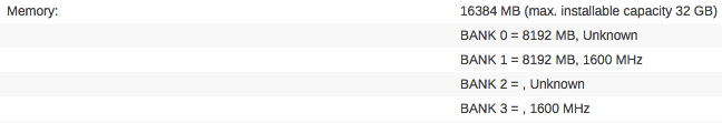

I hope this is the right place for this.
Unraid 6.1rc2
There is bug in the system profiler plugin. Memory is reported wrong. (see pic)
This was also present in Unraid 6.0.1
Kevin
[Edit] I also tried it in Safari. Cleared cache. No change. Chrome and Safari on iPad are the same.
Unraid 6.1rc2
Kevin
Which version of system profiler are you using (see plugins tab) ?
Unraid 6.1rc2
Kevin
2015.6.27.
Kevin.
