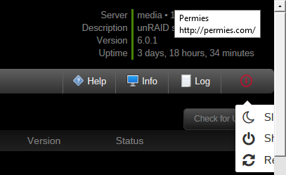

I'm using Firefox, and the 3 options run off-screen to the right (see screenshot).  Possible to have them extend left if they would otherwise run off-screen like this?

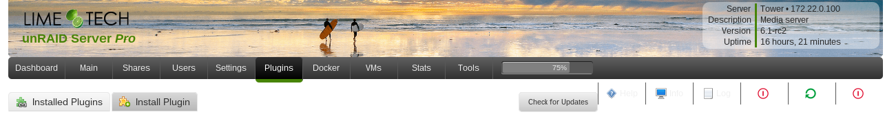

I have followed this procedure, and cleared browser cache, but I still have the red and green buttons displayed.
If I re-install, it simply adds the third button back.
I have the same three buttons and none of the buttons seems to result in any action when click.  The left button provides a dropdown menu which gives a choice of shutdown or reboot.  The 'reboot' option displays the "System is rebooting..." banner" but, after clicking on the server bookmark, the GUI reappears immediately!  The center 'Reboot" button results in the same sequence.
I have not tried either the 'Powerdown' option on the dropdown option or the right 'Powerdown' button but I suspect a similar behavior.

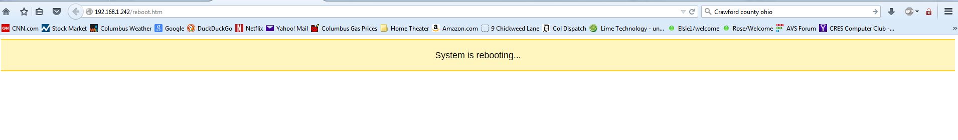

This morning I decided to try again.  I first uninstalled the Systems Button plugin.  The plugin was gone but the buttons were still there.  So I rebooted the server using the "Array Operation' tab.  When the server came back up, all the buttons were gone!  So far, so good.  I now reinstalled the System Buttons plugin using the 'Install Plugins' page.  That worked.  I now have only one button.  And clicking on that button, displays the dropdown menu.
Now for the problem.  When I click on either option on the dropdown menu, The appropriate banner appears BUT nothing else happens!  The server will neither reboot nor shutdown.  Now remember that it just did a reboot, two minutes prior to this attempt (using the button), using the old sequence in the 'Array Operation' tab.  I even ran the two commands in the above post and both times the file or directory was not there.

The normal sequence is that after pressing the button a popup windows appears (see picture) telling that preparations are taking place, once these are done the normal shutdown or reboot screen is shown.
You are saying none of this happening?

Nor for me either. I get the 'standard' system is rebooting screen, but nothing actually happens.

Nope.  This is the only screen that appears and it has been there like that for for more than two minutes.  As I said, if I click on the browser bookmark, the Main GUI page returns.  It appears to be that nothing happens beyond that point.
Ok, that screen says that the system is actually rebooting and it won't change (same as when the Reboot button is used). When you manually reload the main page you can verify the uptime.
